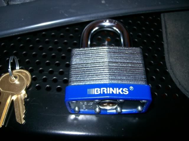

How do i pick this Brinks lock?

It's a pretty basic padlock. Alot of Brinks locks have security pins but it should not be to tough. Are you familiar with the basics of lockpicking? If we know your skill level it's easier for us to explain in a way you will understand.

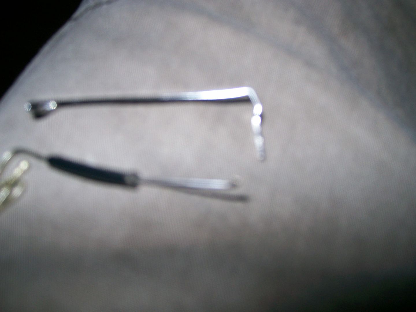

but now with this lock is hard, im using a bobby pin and a tension wrench made from the metal part of a uni ball pen like in the video.
My question is, how do you know which pin is binding the most, and how deep should i put my pick becuase it goes pretty deep in the lock and i dont know if it should go that far/ if any pins are back there

Also heres what im using for tension wrench and pick in detail
http://i86.photobucket.com/albums/k115/ ... e004-1.jpg
http://i86.photobucket.com/albums/k115/ ... e003-1.jpg
http://i86.photobucket.com/albums/k115/ ... e002-1.jpg
http://i86.photobucket.com/albums/k115/ ... e001-1.jpg
Im 16, i would buy an actualy set but i have no credit card so i cant but if you know a place that will take cash(mail in) thats reliable that i would go there.. doubt it though :( so this is what i must make due with
and if you have any suggestions on how to make a better pick and tension wrench please share. I have no grinder/ filer

buy a set of files from random hardware store, get to a junkyard and ask if you can take some windshield wipers for free or a small price, remove the inserts in teh windshield wipers, cut to length and then file to resonable picks, then sand then :)

First of all, you put way too much tension and your paperclip is too soft,
basically because you force it too much!
Solution, light tension slowly lift the pins, do not try to pull them out of the
lock!

try to get some information into any photos you post, after opening the first one, I just decided not to look at any of the rest of them since it showed nothing and was posted with out regard for our users bandwith.

Remember, many padlocks have a spring on the cylinder to push the cylinder back after the key is turned. If this is the case, you will need to have enough tension to overcome the spring, but not make the pins bind so hard that you cant pick them. Very difficult if you're just starting out.

I actually have this lock and I remembered it being relatively easy to start. I was pumped that I was able to pick a "maximum security" Brinks padlock. For some peculiar reason, I haven't been able to pick this recently though. Keep at it, you should get it. Perhaps you might want to consider putting it down for a while and moving on to a different lock for a little bit and then come back to it. No use banging your head against a wall. Have fun, and welcome to LP101.
