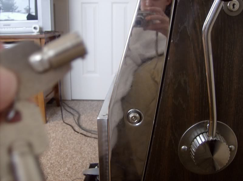

by excalibur1210 » 14 Jan 2008 14:37
Thanks, PPP.
Here's the machine and the key. Can't show that the key works, since the problem is that the key isn't working.
(sorry the image is so large. I don't have a photo editor)

by freakparade3 » 14 Jan 2008 14:45
If the key will not work it's unlikely picking will either. It's also extremely hard to pick this type of lock without the proper tools. By hand you will have to pick it 7 times because the pins will relock into the next hole every 1/7th of a turn. Buying the proper tools will cost more than a locksmith. So in summation, you need to call a locksmith.

by MBI » 14 Jan 2008 15:32
First of all excalibur1210, I'd like to complement you on the towel you're wearing. How do you manage to get your whites so white?
One thing you could try (assuming you can do this safely) is to lean the machine pretty far over towards the side that has the lock and have someone hold it there while you try the key again. Insert it very carefully and if it doesn't turn, wiggle it gently back and forth a few times. If the lock has a weak spring it could be letting the pin slide too far in when you insert the key and leaning the machine over could help gravity do the job that the spring is supposed to do.
If you do get it open, don't relock it again. Get the lock replaced while you have it open. I know that's stating the obvious, but I figured I'd say it just in case. Better safe than sorry.
If that doesn't work then I'm afraid freakparade3 is correct, time to call a locksmith.

by excalibur1210 » 14 Jan 2008 15:54
MBI wrote:First of all excalibur1210, I'd like to complement you on the towel you're wearing. How do you manage to get your whites so white?
Why thank you. There's a little trick most guys don't know about. Don't throw your whites in with your colors. MBI wrote:One thing you could try (assuming you can do this safely) is to lean the machine pretty far over towards the side that has the lock and have someone hold it there while you try the key again. Insert it very carefully and if it doesn't turn, wiggle it gently back and forth a few times. If the lock has a weak spring it could be letting the pin slide too far in when you insert the key and leaning the machine over could help gravity do the job that the spring is supposed to do.
This sounds promising. And perhaps a little dangerous-- the machine's 300lbs. I'd like to avoid calling a locksmith though, so I'll give it a shot this evening when someone gets home.
