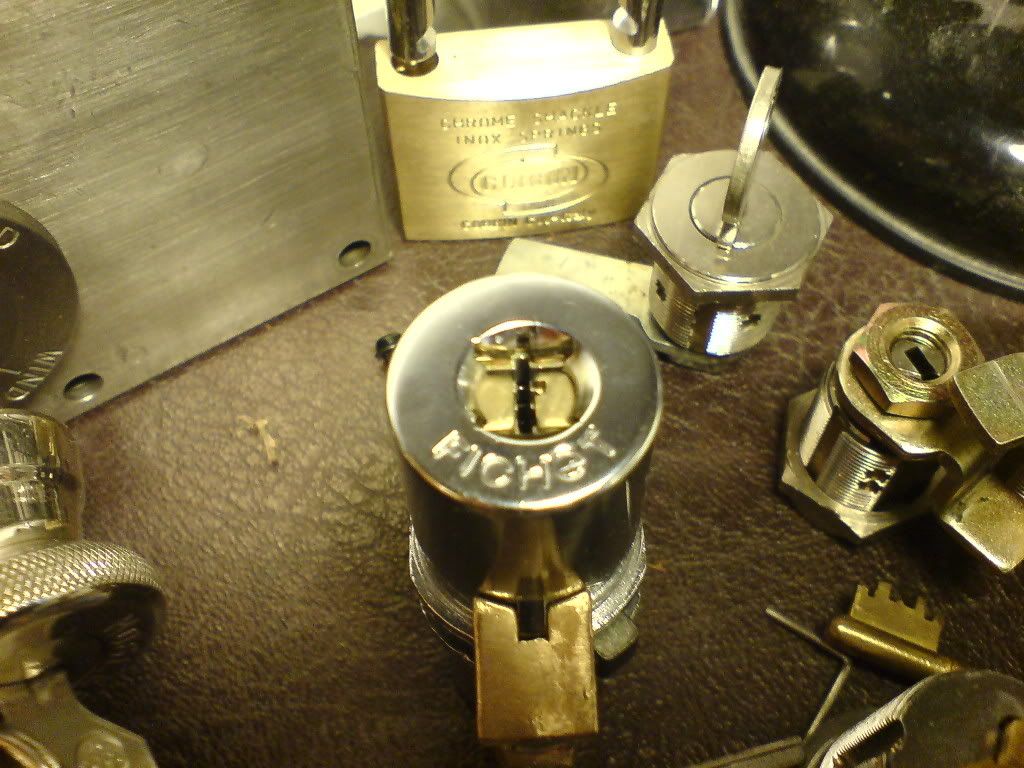

I have a Corbin padlock on my desk. It can be seen if you look in the background of this image LINK
It had 1 spool and 1 mushroom pin as security.
It has "Made in Italy" stamped into the face, so I looked around and found that ASSA Abloy bought Corbin Russwin in 2000, Black and Decker owned the european Corbin based in Bologna Italy and ASSA were looking to aquire these assets in 2004.
I'm not sure if they did or not, as I have no more time today for investigation, but here's a link to the info. PDF Link
