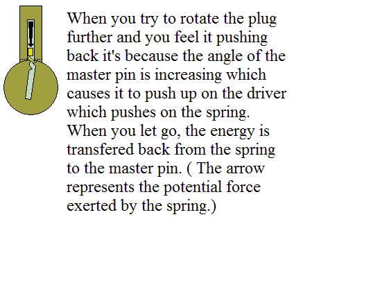

yoursname wrote: oh btw its also has a master key, I dont know if that makes a difference.
It does. A master pin might have fallen into the keyway. Try taking a pick with a flat bottom and using the flat bottom to push up where the bottom of the key way is and turn it in the opposite direction. I'll sketch up a pic of what's on in a moment (squelchtone had made one before but I can find it now.)

by Safety0ff » 28 Apr 2008 12:39
When I saved it the format conversion changed the colors. Oh well. I'm not saying that this is exactly what's going on, but I think it's this or something similar.
yoursname wrote:]So next time dont assume what you dont know, because it makes u look like an donkey.
Word. @$$-u-ME.
Like I said the answer is out there anyway, and someone will give it anyways even if you don't bumber.
