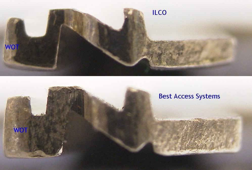

Re: Bulk SC-1 keys not working
Postby WOT » 20 May 2008 15:25
There's clearly difference in third party and OEM.
Both of these keys are supposed to enter the IC CORE K keyway.
Well, they both do.
But the top one(Ilco) enters an M keyway too and it is NOT supposed to. The bottom one(OEM) is positively blocked out from entering an M keyway. They look similar but different enough to be functionally different.
CLICK FOR FULLSIZE
