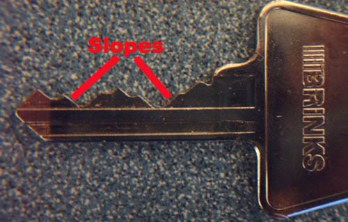

Postby jimb » 7 Jun 2008 20:45
metroid9824 wrote:What exactly do you mean sloping the cuts?
If you don't get enough angle on the slopes the key will not enter or exit the lock, depending on which side of the valley is too straight up and down.
