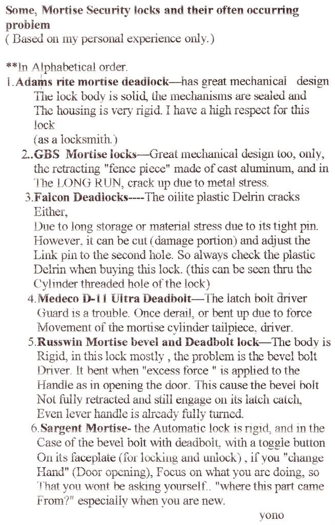

Some, Mortise Security locks and their little downside.
Postby yono » 9 Jun 2008 12:47
note: This is based on my personal opinion only, However i feel it will
benifit others too. especially to new locksmiths.
http://s302.photobucket.com/albums/nn11 ... 0002-3.jpg
