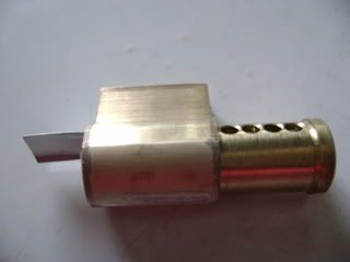

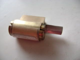

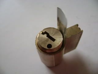

I bought a cheap deadbolt and was able to pick it in minutes. I kept adding spools, but kept finding it easy, so I reassembled it with 5 spools. After that, I couldn't pick it; and because I was stupid and did a configuration I didn't have a key for, I couldn't get it open. I'm sure this is far from a new technique, but this is the solution I came up with:
Basically I cut a small shim and slid it in from the back. I used a stiff pick to raise the pin stacks to the shear line and used the shim to bisect them one at a time. When I got all 5, the plug came out and I could repin it again.

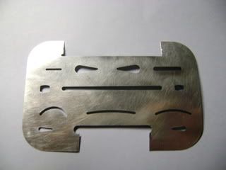

Postby Trip Doctor » 17 Jun 2008 0:36
I'm interested in what you cut the shim out from, because you need a very thin shim to slide into there. (They sell them btw.)

Postby _ » 17 Jun 2008 0:47
Trip Doctor wrote:I'm interested in what you cut the shim out from, because you need a very thin shim to slide into there. (They sell them btw.)
You know something? I wanna know what it is too. I found it on the floor of the drafting room at school and I only have one piece. All I know is that its a lot better than soda can.

Postby criminalhate » 17 Jun 2008 0:51
it's a drafting template for drawing the shapes that are cut into it.
Try and draw a tear drop shape with out one then use the tear drop cutout on it and see which is better =P
If you hadn't cut it up you could have asked the drafting teacher where you could buy them at. Now it might be a little hard to explain why one of the templates is missing pieces.

Postby jpb06080 » 17 Jun 2008 13:10
I usually just use a key blank for this. You can buy shims pretty cheap. The only time they won't work is with kik cylinders that are still in the lock.

Postby Raymond » 17 Jun 2008 18:24
The plate you cut your shim from is an eraser shield. They are very expensive. :shock: When drafting and you need to erase a very small area without disturbing the other drawing, simply lay the shield over the area. One of the precut shapes will be about right. Use your pencil or ink eraser on top of the shield.
Today, most drafting is done by computer but the erasing shield is still very useful.

Postby freakparade3 » 17 Jun 2008 18:43
_ wrote:
jpb06080 wrote:I usually just use a key blank for this. You can buy shims pretty cheap. The only time they won't work is with kik cylinders that are still in the lock.
Wait, you mean you can shim some locks from the front? Most plugs I've seen have a greater diameter at the front as to prevent this.
What he means is you need access to the back of the cylinder to shim it. KIK locks don't give you that access. You insert a keyblank all the way into the lock, then insert your shim into the back. As you pull the blank out you push the shim in at the same time. This traps the driver pins above the shearline.
