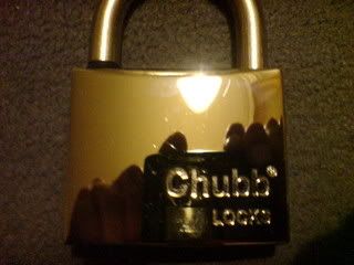

A few weeks ago I decided to embark on a new challenge as I'm finding my current lock collection a little too easy to open.
I hope this doesn't turn in to a rant - I just feel like expounding on my difficulties if anyone cares ;)

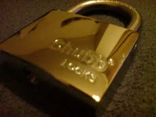

I bought a lock similar to this one from a local shop because it was quite expensive and just look at the shiny shiny:
It is a marine grade (salt water tested) padlock. This particular model has steel pins to withstand the salt weathering - apparently. (unlike the one in the link)
I like shiny things

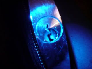

Its got a pretty knarly key way:

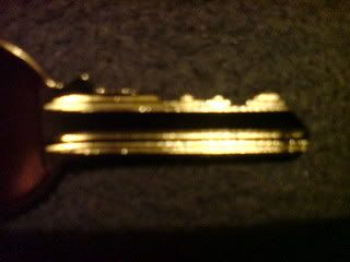

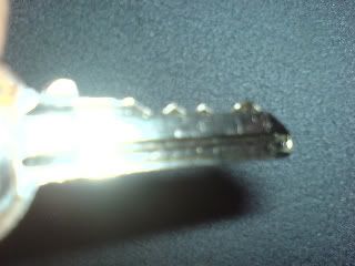

And the bitting on the key is pretty horrendous in my opinion: (bad pics alert) the first and last pins need to be lifted virtually all the way up and the 3 middle ones are quite low.

The Steel pins should affect the picking, remember you are pushing against the resistance of the springs, so the metal of the pins shouldn't affect the "feel" of the lock very much.
That's a pig of a keyway alright. For some reason over here in Europe, highly-obstructed keyways have been common for devades, but not in the US apparently, where they are still relatively new. Always struck me as odd that a big company would issue such different locks for different countries.
