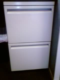

This shows the front of the cabinet.

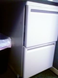

This shows an angled view....where you can get an idea of my predicament...

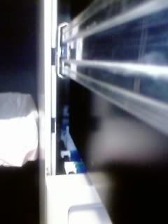

View with top drawer open, showing sliders on drawers...

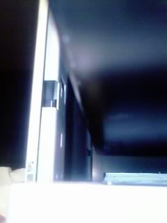

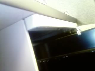

View looking at top drawer fitting into frame....not possible to secure both drawers simultaneously here...
View between bottom drawer and top drawer, showing cavity between cabinet frame and where the edge of the drawer is.

Looking at your last pic, it seems there may already be a bar to lock the drawers in place fitted into the vertical member. It may be that there are locking and non-locking versions of this cabinet, and all you need to do it find a way to fit a cam lock which will operate the bar already present but not connected to anything.

@mhole....the channel inside is empty.....nice thought but....(it was the first think I looked at).
