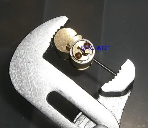

Postby WOT » 9 Dec 2008 1:12
Like this:
The rod is the shank from a 1/16" drill bit. Cut it with a Dremel, then round off the end to minimize damage to the bottom pin.
Bottom pins will be damaged, so they SHOULD be replaced, but you don't have to.
Springs and caps MUST be replaced.

Postby ridinplugspinnaz » 9 Dec 2008 1:16
WOT wrote:Like this:
Putting it back together without a capping block? Forget it.
So I guess it's safe to say that the spring will never come out of the lock quite like it went in, eh? That's unfortunate. What do lockies do with the springs and caps, recycle them or something? Seems like a waste of materials for those institutional guys who probably go through hundreds a year.
