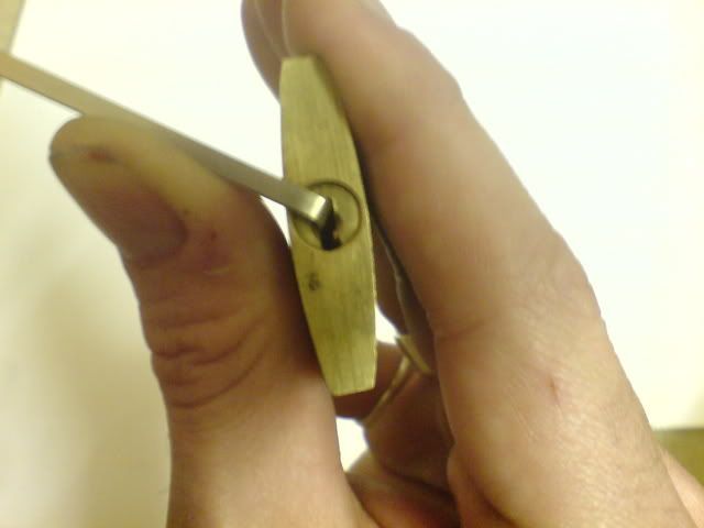

Postby Olson Burry » 5 Feb 2009 12:22
If you can bring yourself to modify one of your wrenches to be used specifically for top tension, they are always useful in cases like this. You can get away with a normal sized one but you will find it slips out quite easily and may interfere with the first pin, which you dont want.
Here's how I use a shortened wrench on a similar lock. There is plenty of room left to get a small hook pick under there to manipulate the pins:
Be careful not to apply too much tension, just enough to counteract the spring and lift the pins carefully so you dont get an overset. If it isn't binding, go to the next one, eventually you'll get one that clicks in to place and binds the next pin.

Postby nixon » 5 Feb 2009 12:29
Thanks very much both you guys.
The lock on your picture Olson Burry does look exceptionally similar to the one I have here. One of the tension bars I have,actually has a smaller head than the other 3.
I guess most people struggled to pick their first lock,and although I have done this once,no skill was involved.
I'm just going to have to persevere with it,and concentrate on setting all the pins.
