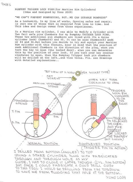

Postby yono » 24 Feb 2009 5:57
to my fellow locksmiths

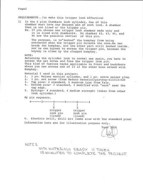

Postby yono » 24 Feb 2009 6:02
page 2: Bumpkey trigger lock pins.

yono wrote:to my fellow locksmiths
Ok..... I like the idea, but I see one problem. If someone uses a bump key on your lock and gets ir binded up with the trigger pin, what is to stop them extracting the bump key and lifting the trigger pin with a pick?

Re: BUMPKEY TRIGGER LOCK PINS- a one step defense
Postby yono » 24 Feb 2009 6:20
As i explained, in the requirement, this feature should carry one deepest pin, not align with the trigger pins. this "deepest pin" will trapped the bumpkey. it cant be bypass, nor it can be lift up, for it stuck on the cylinder wall.
Postby SnowyBoy » 24 Feb 2009 7:30
yono wrote:As i explained, in the requirement, this feature should carry one deepest pin, not align with the trigger pins. this "deepest pin" will trapped the bumpkey. it cant be bypass, nor it can be lift up, for it stuck on the cylinder wall.
Its not possible to bind the key in though. If all the cuts are 9 (being a bump key) then that means the lock pin will have to be a 10, which does not exist.... thus allowing the key to be removed with no hindrance whatsoever.
Postby SnowyBoy » 24 Feb 2009 7:32
Also, the fact that the lock pin is sprung to fall in to the cylinder to block it means it can be overlifted since there is nothing locking it from going back up.
Postby yono » 24 Feb 2009 8:24
thanks for another quest, lets put it this way, pinned a cylinder, let say, a sargent, on those pin put one that is its deepest, that pin would be .355" , now insert your bumpkey, turn the cylinder, from its vertical axis, 45 degrees, on that position, pull the bumpkey out.can you extract it. without bringing it back to its original axis?. lipting the trigger lock pins is not possible, when the bumpkey itself, stuck and trapped at the key hole. thanks for the question.
Postby Engineer » 24 Feb 2009 16:40
Hi yono,
This does sound like a good idea, but I too couldn't see what there was to stop the trapping pin from just being relifted.
I don't know if my idea would work or not, but I think I mis-read your diagram. I thought the trapping pin was a spool pin? Now what I thought was that once the trapping pin had entered the cylinder, trying to pull the key out would upset the trapping pin just like trying to pick a spool pin. The spool pin would be wedged then and you could not "pick" it back into position again as the bump key would be blocking the keyway?
Just a thought.
