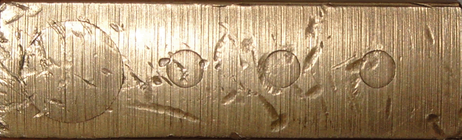

I want to do that to my Abus 65/50 but I'm not exactly sure how to do it, I read Snowyboy's guide on how to dismantle a padlock and Jebus's on how to disassemble a padlock.
The thing is that my Abus only got three pin caps, here I'll show you Image
Does that matter for cutting it or have I misunderstood something?

Looking at your photo you have more than 3! Between the two you have sunk on the right there is one more hiding there... and i can also see the faint outline of another one on the far right.
Try again, this time put the lock on a hard surface and get a peice of rod or a small metal screwdriver and place it dead centre between the two caps you have already sunk.... they will appear I can assure you.

:oops: Yes I can see that on that picture now yes, I tried your method but I failed...
After drilling the small pilot hole I screwed in the screw and it somehow broke... Don't ask me how, was almost no pressure added or anything like it. Then I had to drill out the screw to try again, guess what! The drill broke inside the pilot hole and I had to drill that up as well... That's not all, the retainer bar bent inside the lock and jammed it completely ( I cut open the lock to figure out what happen, I also found out that all the pins were safety-pins! Four Spools and one serrated.)
Btw: Can't wait to see your cutaways!

You have to use a screw with a course thread to bite into the brass retainer.... and when you lift it, it has to be dead straight.

I did but I think the screw was damaged, what diameter is the pilot hole you drill?

I just picked up a drill bit that looked smaller than the rod.
