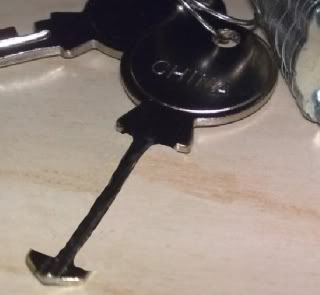

Indeed. As an experiment you could try grinding/filing down one of the keys a bit like this (without the crappy paint skills):
And it should still work. This would also work for all other locks like that as well so it might be a useful addition to the tool box.

Alternatively of course you could make something *like* that, using the key as a size gauge. Just needs to be a T shaped thing that you can put all the way in and turn to release the mechanism really.
Check out what a set of warded padlock picks look like.

Make a skeleton key like shown above.
When this still won't turn, try put some candlewax on the key and then you can see where it blocks and file that out... Repeat till the lock opens :)

I made a skeleton key, based on the original. It works but the strength of it is questionable. It seems to bend easily if not turned properly, but with careful operation it works. How do you know how wide the tip of the key should be?
