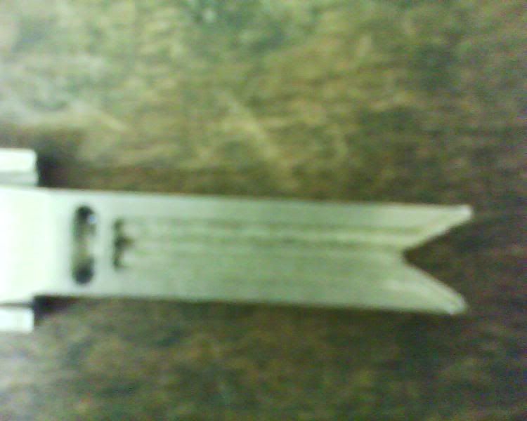

Postby weerwolf » 30 Jul 2009 15:32
We use a special key that has a groove in the middle. This brings all the sliders up to the correct height , to create a shearline. Without the sliders , there is only a clip or 2 screws (rim lock) holding the core in place.

Postby weerwolf » 2 Aug 2009 13:22
Here is a pic showing the key.
This can be made using a dremel.
