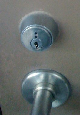

I recently saw a lock with a very odd keyway, and am dying to know what it is.
Disclaimer: This lock is clearly in use, and I don't want any info on how to pick it, bypass it, etc... I just want to know what the heck it is, and perhaps what the "holes" are for.
Additional Info:
  • Everyone I've shown this to immediately jumps to the conclusion it was drilled, but in person it is clear the holes in the face are factory-made.
  • The rest of the building this lock is in appears to be Sargent i-core locks
  • The central part of the keyway is about the size of an Abloy key
  • The "squiggle" descending from the center of the keyway is wider than the blade on a normal key
  • There appears to be writing on the faceplate in the picture, but I don't remember seeing any writing in person, so it may be an artifact of the hastily taken camera phone picture.
Hasty camera phone picture:
Sketch:
So what about it LP101? Any clue what this creature is?

Can you give some more information please? The lock appears to be in use ....what kind of place is it ?? Hotel/motel? School ?office ?

The lock is in use. I saw it in a very publicly accessible area in an airport. More specifically it was securing a door to a room which was marked something generic like "storage". The door swings outward, and there was no protection over the strike, which sorta argues against high-security, but so does the Master #3 I saw the TSA using to secure some stuff. :)

My best guess not ever seeing anything like that before would be some type of electronic/physical master key type system- The hole in the actual keyway would be for the electronic "tag" on the key blade, and the two holes above are for an electronic management device to allow/deny certain users and for user history...

That is an intellikey lock, I don't know much about them, here is their home page: http://www.intellikey.com/ They look like pretty interesting locks.

SFI wins! Thank you! This is almost certainly what I saw: http://www.intellikey.com/products_cylinder.html

is it like a key with rfid chip in it??

To me, it looks like the key would emit a series of pulses from the led lights in to the holes above the key-way that are unique to the key. That would then be processed by the central locking system, logged and access either granted or denied.

the key has a pasive transponder (eg no batteries)
I have seen these locks on a number of US airports
they are programmed with master key and have a wide range of functions and can be remotely monitered
physically the key blank has only 1 pin the rest is in the electronics

And then Olson Burry is right about those holes being for led's ?
Im thinking that the holes are LEDs and perhaps only one red and one green to indicat the state of the lock, just like a Marlok

Yes, Olson is correct. If you look at the product page, the key blade is basically there as an alignment guide and plug for powering the on-board micro controller The two LEDs are actually one IR LED and one IR photosensor. They line up with the two holes to communicate via an encrypted protocol. (There is a handshake, and some other bi-directional communication, including audit trail, which is kinda cool)
What is a bit sketchy is that the details of the "encryption" are disclosed anywhere I can find, which is seldom a good sign.

Could've fooled me! It looks like someone had a few unsuccessful tries at drilling it out! :) :D
