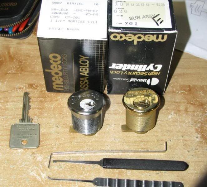

As for the keyways, I have absolutely no idea since I am no medeco expert, however I do have a picture of the two locks here with their corresponding keys next to them so you guys can get an idea of the bitting and possibly tell me what type of keys they use. The key for the silver lock does not fit the brass lock and the brass lock key does not fit the silver lock key. The brass lock keyway is much more restrictive. Both of them I pick with top of keyway tension.

The left one is Patriot keyway and the box should say -PAS on it. What -_ _ S does the box on the right say? Example: G3S, B3S, X3S, S1S, X3S

The left one (Patriot) says 10W0200 - -05-PA
The right one has the part no 10W0200 - CS

The back of the non-patriot key has a code that starts with WBS. Don't know if that has anything to do with it but I thought I might post in case you might now Squelchtone.

Here is another picture of the locks in the picked position plus the tools I used to pick them. I also rotated to boxes to make the text on them clear.
