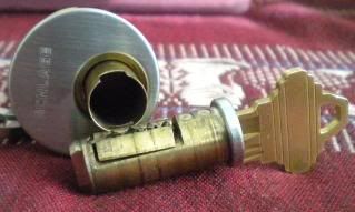

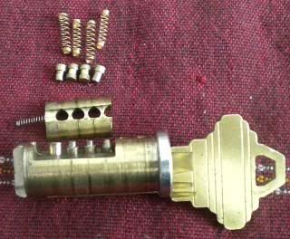

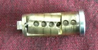

Postby FarmerFreak » 22 Oct 2009 16:38
This is the lock I mentioned earlier.
If the plan was to have a lock and only pick it to get into it. This would be a cool idea if set up the other way around. So you need to lift the last pin in the lock just to unlock the movement of the first 4 or 5 pins.
Actually now that I am looking at it. The only reason the first pin moves the slider is because I wanted a key to work. Any position could be used to unlock the other pins, not just the first/last one.
This way even if someone else were to try and pick it they wouldn't likely know why the pins aren't moving!! :mrgreen:

Postby LocksmithArmy » 22 Oct 2009 16:53
That is a cool lock... You made it right... did you cut the piece out of the cylinder or grind it out of one cylinder and cut the piece form another cylinder...
LocksmithArmy
Posts: 989
Joined: 25 Jun 2009 22:14
Re: Using Locks Without Keys
Postby FarmerFreak » 22 Oct 2009 17:39
It's made from two cylinders. I did most of the work with a flat file. I know there is faster tools to get the job done, but I was simply playing around that day. With some time to kill.

Postby LocksmithArmy » 22 Oct 2009 17:41
its still a pretty dern good idea for picking fun...
