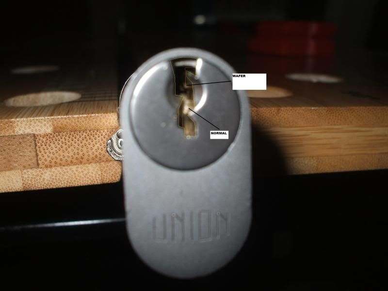

I have a new union lock here with no key.
Its an oval euro 6 pin with 2 offset antidrill pins in the cylinder. (sorry no pic)
been struggling picking it and couldnt understand why it doesnt look special.
just noticed today after a good clean with some wd40 that there are some strange wafer looking pins in the top of the cylinder slightly to the right of the pins...
cant believe i didnt see them.
gonna go pick it now (hopefully)
any ideas??? :?

Postby Rickthepick » 22 Oct 2009 9:15
ok stole the batteries out my clock to get a pic :lol:
not the best pic but i think you can see the shape of the keyway and inners enough to identify

Postby Solomon » 22 Oct 2009 11:05
Judging by the shape of the keyway, you have your hands on a Union DTEC. What you're seeing is a sidebar; I don't think we can discuss those in the open forums.

Postby Rickthepick » 22 Oct 2009 13:31
not sure its a sidebar its definately individual wafers of some description

Postby Solomon » 22 Oct 2009 13:49
Rickthepick wrote:not sure its a sidebar its definately individual wafers of some description
All new Union cylinders are 6 pin with the offset anti-drill pins like you described. The only oval cylinders in their current range are the 2X6 (key blank KB502) and the DTEC, which has a pretty distinctive keyway - same as yours. So yeah, it's definately a sidebar. However, they seem to be area specific and to the best of my knowledge, area specific sidebars are passive elements. They're only in place to stop keys blanks from other areas being used for duplication purposes, so they don't actually have any effect when it comes to picking. :)

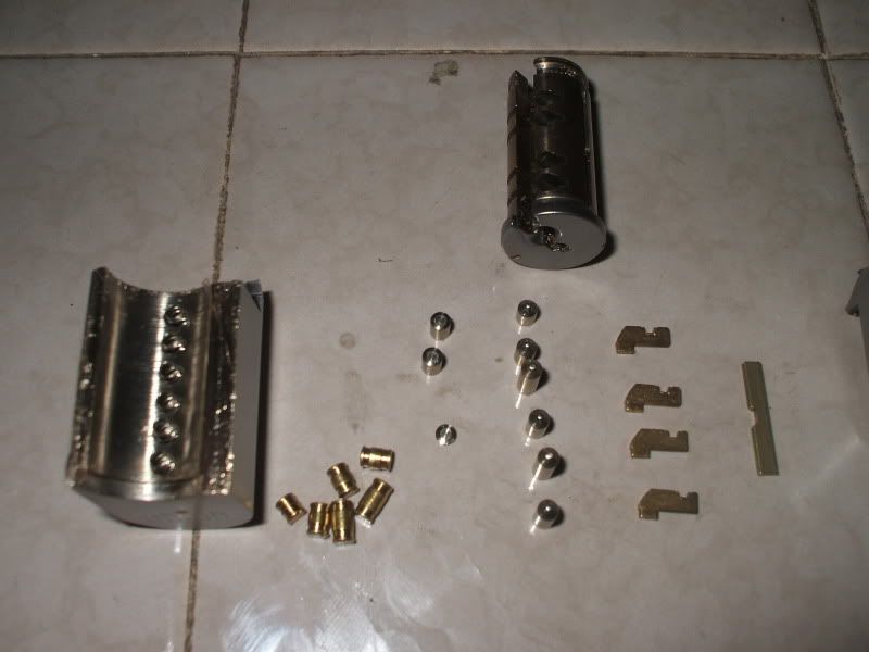

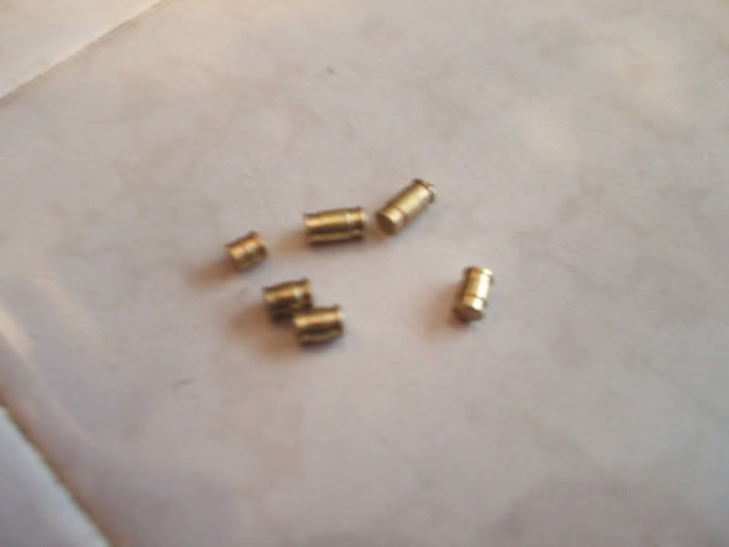

Postby Rickthepick » 1 Nov 2009 8:51
iv just give up and chopped the top off this lock to open it up.
awesome serrated driver pins and a 4 wafer sidebar mechanism. :twisted:
il just take some pictures and then i will try and pick the other half of this cylinder.

Postby Solomon » 1 Nov 2009 18:23
Heh, told you it had a sidebar! ;)
Those drivers look pretty nasty, the ASSA that I had for a while had pins which were identical to those, and it was an absolute nightmare. I see master pins in there, so the extra shear line those couple of pins will give you should make things easier. Keep at it, again I don't think that sidebar needs to be picked but see if there is any movement there anyway. Come on man, you can do it! :mrgreen:

Postby Rickthepick » 2 Nov 2009 3:31
the sidebar is pickable the gates in the wafers are all different heights and drop out of place very easilly.
Id love to pick this i just needa quiet moment and a bit of luck :lol:
