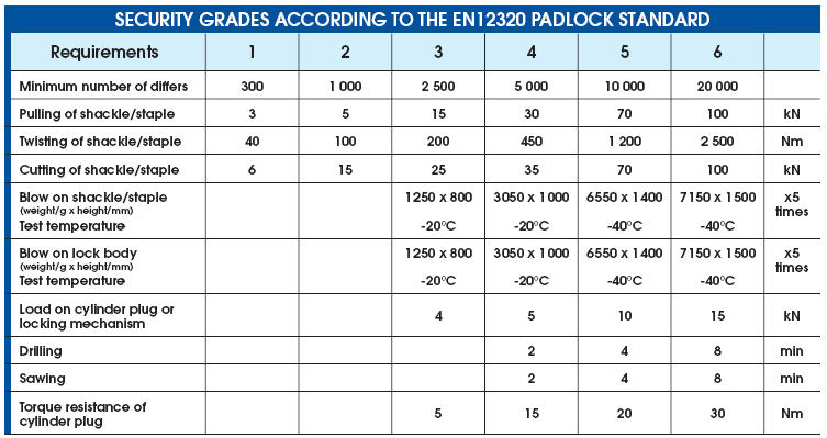

For padlocks there's also British Standard EN12320 and Scandinavian SSFN014
