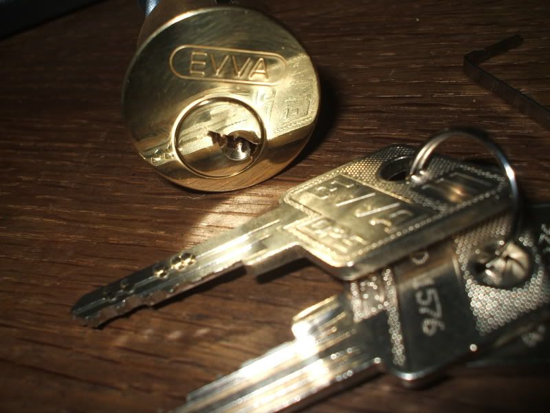

Postby Rickthepick » 1 Dec 2009 9:36
anyone had any experience with this lock?
Im due one in the post

Postby datagram » 1 Dec 2009 11:45
Besides whatever that piece in the front of the plug is (better view at the back), it looks equivalent to older pin-based EVVA DPS locks. More info available at http://lockwiki.com/index.php/EVVA_DPS.

Postby SnowyBoy » 5 Dec 2009 0:24
Passive sidebar is useless, don't have to worry about it. I made a cutaway of a DPs and they are pretty similar.

Postby ponsaloti » 8 Dec 2009 17:49
dps=5 pin, eps=6 pin, therefore e=extra

Postby SnowyBoy » 8 Dec 2009 20:02
ponsaloti wrote:dps=5 pin, eps=6 pin, therefore e=extra
The EPS in the pic is only 5 pin though :shock:

Postby sfi72 » 8 Dec 2009 21:27
Yeah, the photo is rather precise, i doubt they would have forgotten a pin, but remembered to have the longer spools. My guess is something to do with that plate at the front of the plug, that datagram pointed out earlier.

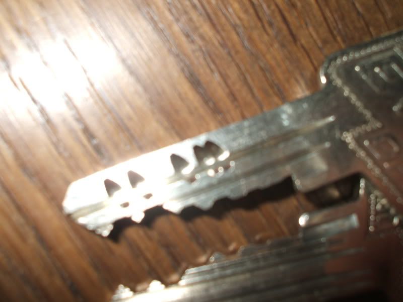

Postby Rickthepick » 9 Dec 2009 7:36
The ebayer has sent me a DPS instead, not sure of the difference.
I just picked the DPS no sweat
BUT
it locks up at a 45 degree turn, i take it that means the sidebar bit has come into play. Im not gonna try and pick further and risk not being able to return the plug as i do plan on fitting this lock :lol:

Postby Rickthepick » 9 Dec 2009 7:38
oh. Actually it wasnt jammed HAHA my tension wrench was catching something.

Postby Rickthepick » 9 Dec 2009 7:47
Suprising simple... Not sure where the sidebar bit comes into play :?

Postby sfi72 » 9 Dec 2009 8:20
Rickthepick wrote:Suprising simple... Not sure where the sidebar bit comes into play :?
The sidebar is passive.

Postby GutterClown » 10 Dec 2009 4:54
The sidebar coding on the key is dealer specific. Your company buys Profile-X and my company buys Profile-X, we get different sidebar codes, so my key cut to the same code won't operate one of your locks.
It's just like an inline-6 restricted key, but with a little added restriction.

Postby aussielocky » 11 Dec 2009 5:48
Turn the plug clockwise with no key in it (ie picked) and the sidebar has a trap in it and it will be fun to rectify.

Postby sfi72 » 11 Dec 2009 6:25
aussielocky wrote:Turn the plug clockwise with no key in it (ie picked) and the sidebar has a trap in it and it will be fun to rectify.
Go on, you know you want to :mrgreen:
Its actually really easy to bypass that "trap", just use your pick and prod around in the general area of the sidebar, with a little practice you can do it in a couple seconds.
