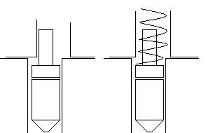

Postby FarmerFreak » 13 Jan 2010 20:44
To add to what I just posted.
Here is what is inside the lock.
The diagram on the left is what your top and bottom pins look like. The diagram on the right is what happens to all shallower depths when you try to bind them. The spring gets smashed...(light tension).
If it is a deeper depth, than the sheer line will be on the bottom part of the driver pin and act just like a regular pin.
Hope that helps.

Postby wakeboard1290 » 13 Jan 2010 20:53
Thanks Farmer, I'm gonna give that a shot and let you know how it goes.
