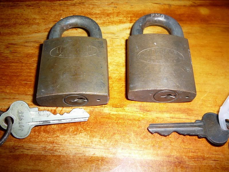

I've got a couple of old Telecom lockwood padlocks. Probably from the 80's maybe early 90s I can't pick them, I am a beginner, so not picking them is not a big surprise. Just wondering what kind of internals these old lockwoods have? There are no special serial numbers on them. On the left one it has the old telecom symbol etched into it. and tips or advice to get into these particular lockwoods?

These are Lockwood 234 6 pin padlocks. Nothing special about them except that the bitting was reserved for Telecom and the PMG. They just use standard pins and drivers The one on the left from Telecom. The one on the right is older and has the PMG (Post Master General) stamp on it's shackle.
A bit of practice and you will soon be picking them

the combination of the one on right, looks like a toughie.

I should also mention that those Lockwood padlocks were accuratley machined with very close tolerances. These close tolerances can be very unforgiving when trying to pick these locks. Also note the high pins after the deep pins. at times these can be frustratingly difficult to set if the deep pin sets first.
If you are just starting out I would suggest you put these locks aside and try something easier until you develope your technique.

I have a lockwood padlock, it is one of the hardest locks I have to pick, nothing special about the pins as mentioned, other than they are stainless steel. Very tight tolerances. I have never picked it, I just look at it!!

thelockpickkid wrote:I have a lockwood padlock, it is one of the hardest locks I have to pick, nothing special about the pins as mentioned, other than they are stainless steel. Very tight tolerances. I have never picked it, I just look at it!!
Lockwood use Nickle Silver pins in their locks not stainless steel.

Those padlocks are no different than virtually any other standard lockwood lock. Spacing is always .156 and depth is .020 increment.
Pins are nickel brass. Top pins are all the same length. Most are master keyed making then even easier to pick.
The keyway profile might be awkward to get your turning wrench in, but using a thinner rake or hook will work fairly well.
