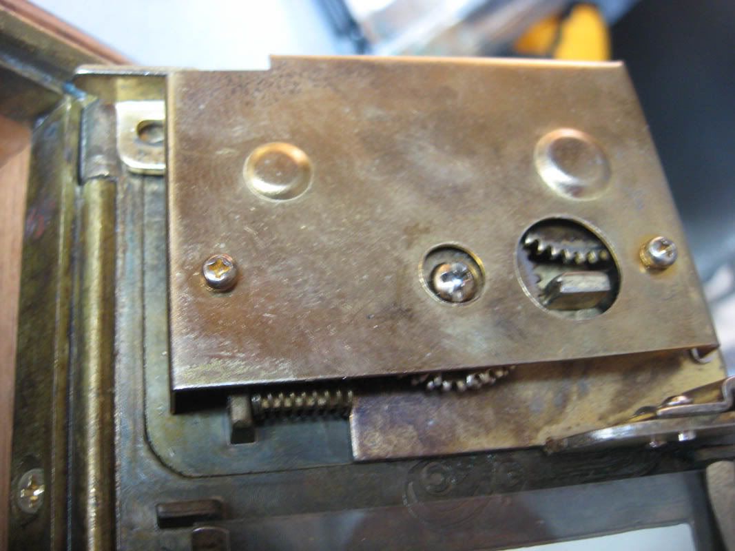

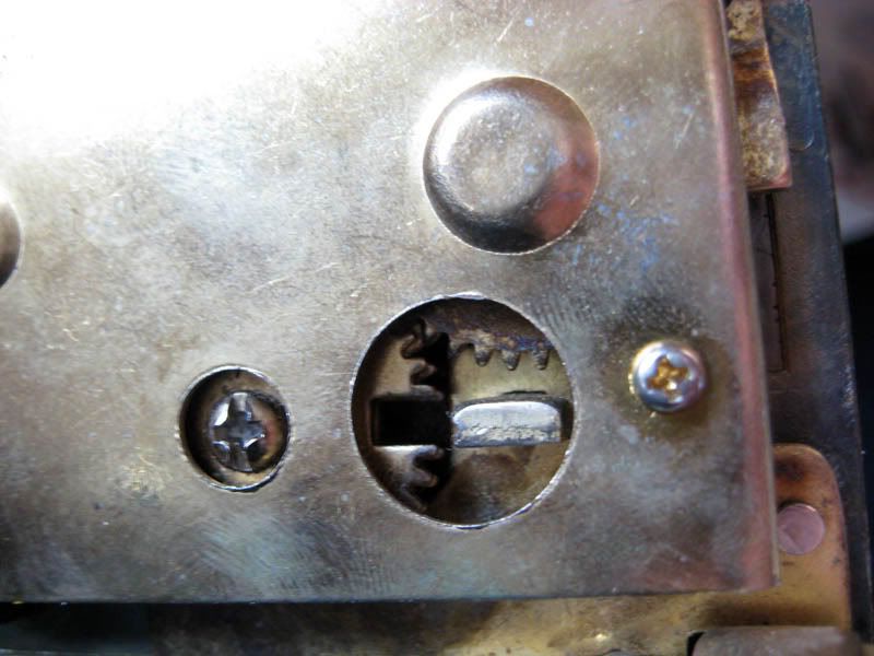

Something I had kicking around. I decided to open it and take some pictures.
If you look closely at that last picture you can see the wheels line up to allow the bolt to move. It's not under pressure so I guess it'd be hard to manipulate unless your putting pressure on the bolt.

I don't think you can pressurise the bolt.
As soon as the bolt starts moving , it should block the dials.

Postby raimundo » 6 Feb 2010 10:34
long ago, in '67, while stationed at Letterman army general hospital in the Presidio, I had such a mail box at the hospital, and it was quite easy to manipulate, some cross forces I remember, perhaps pulling on the door, while turning the wheels, In any case, these are the least secure post boxes I have ever known, and I don't think that the post office has used them for many years.
Re: Inside a reproduction safe
Postby Josh K » 6 Feb 2010 10:38
I just played with it for a bit and if you use light pressure on the latch you can feel it "bumping" over the grooves until it misses a bump. That's where the notch is for that wheel. Took a bit of practice but it wasn't hard.
