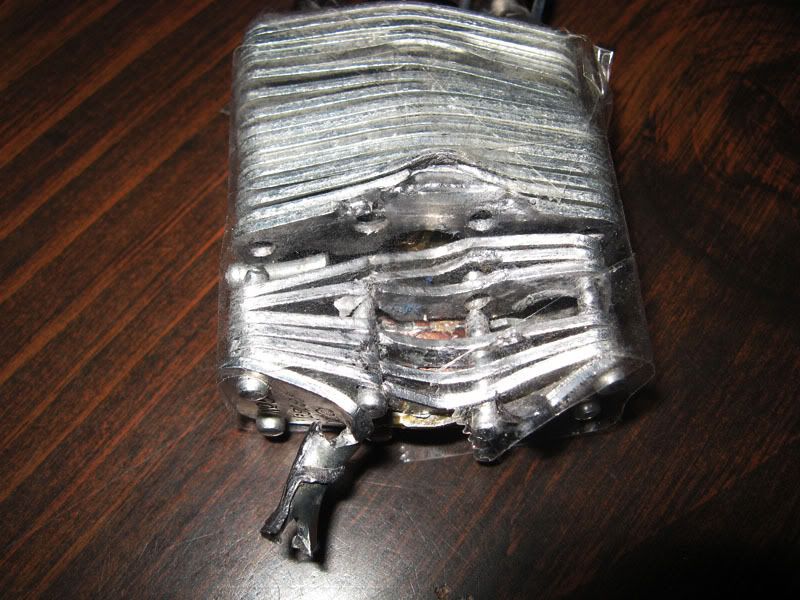

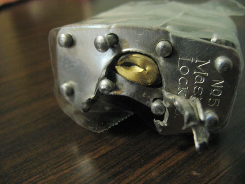

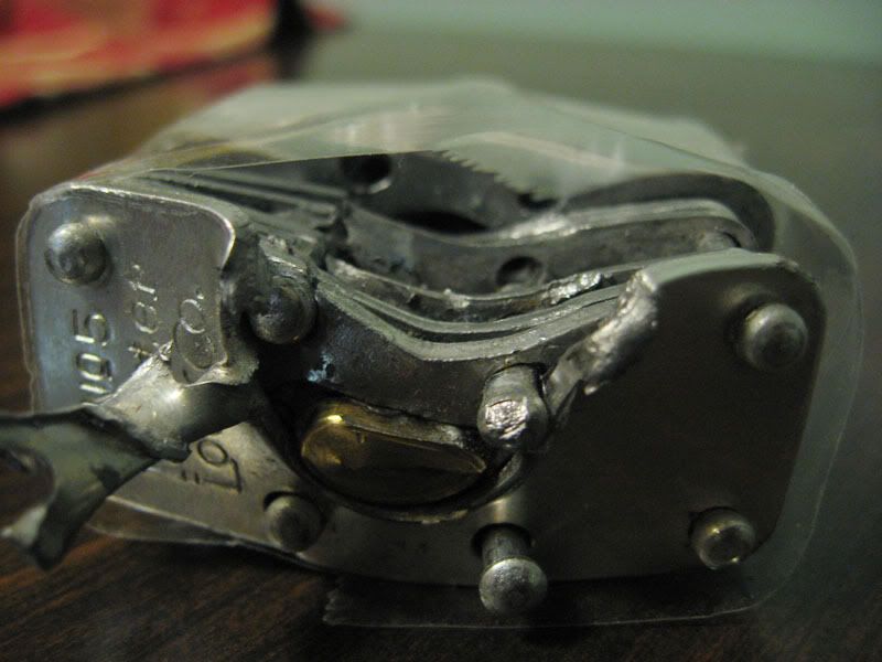

I was curious. Reports on the Master Lock site indicate that it can withstand gun fire from various caliber firearms.
Whatever it was, it wasn't a 3" slug from a 12 gauge shotgun. :shock:
Next on the list are a Master Lock #15 and #930. We'll see how those fair if there's any interest.
You can see how the laminated plates were forced apart popping the rivets off of the top and bottom pins. This in turn causes the entire lock to separate and the shackle to be freed. I'm hoping that the larger sized #15 and the solid bodied #930 fair better.

I think what master ment was that it stays locked... so can you unock it after you shot it...

I'm not following. The lock opened, and is obviously destroyed beyond any real use.

oh sorry bro I couldnt tell from the pix if it had opened... lol

No problems. :) Took five minutes of digging to find all the pieces. The shackle not only popped off but it also sheared. What you're seeing is the result of a half hour restacking the plates and making sure everything was there.

what master appears to mean is that you can shoot the cylinder out of one of these laminated stacks and the shackle will not become unhooked,
what they don't tell you is that if you shoot out the locking dogs just above the cylinder, the shackle will pop open.
loud, dangerous flying parts, not that much quicker than a pick.
