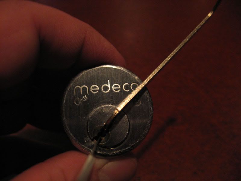

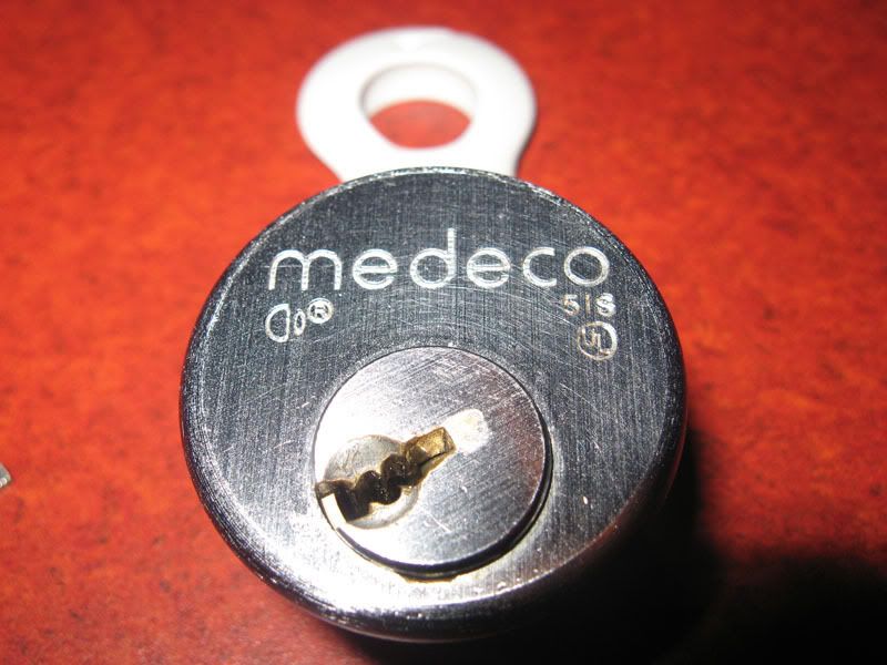

Postby Josh K » 10 Mar 2010 17:16
Some eye candy for you.
I'm going to try and get a set of breakdown pictures taken with steps.
