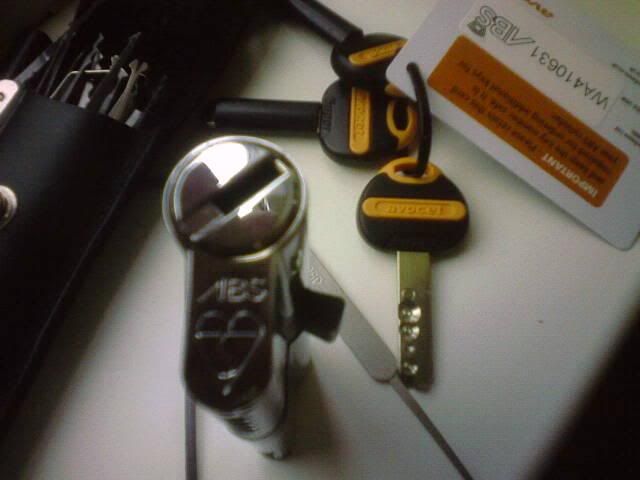

Got it this morning and had picked it half hour later,
pretty easy once you sort the magnetic pin out.
I used a southord half diamiond as its stainless and doesnt pull the magnet out when your picking.
magnet i filed to size to fit perfectly over the front pin chamber
over-rated lock really but good in terms of destructive opening

Postby Rickthepick » 20 Mar 2010 9:08
took me longer to get this pic off my phone than to pick the lock :lol: :lol: :lol:

Postby Rickthepick » 20 Mar 2010 10:08
just realised i have the mk1.
the mk2 has the magnetic pin further back in the cylinder and looks to have an extra telescopic pin
:roll:

Postby Rickthepick » 21 Mar 2010 14:20
was having trouble picking it again, turns out i had the magnet in wrong pole round :P
