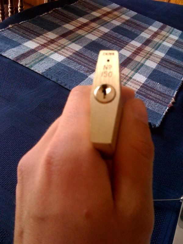

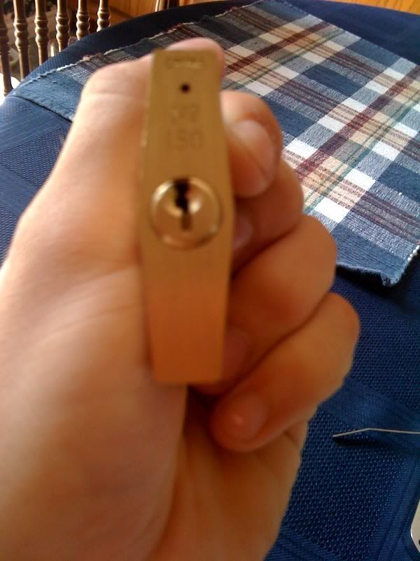

Sorry about the pictures.. It's a pretty common lock; So I didn't think they were needed.. But here they are:
I wasn't able to get a very clear shot of the keyhole and pins.. But - I tried my best!
As for giving it light tension, I have read somewhere else to do that, and when I do, I just don't seem like I'm getting anywhere - I don't feel any pins set.. For example, I KNOW the first pin the key touches is spooled.. And I know when I have it properly set.. I don't know! I guess I WILL just have to keep working at it :D
Any other tips would be greatly helpful! Thanks, everyone!

Sorry! Bad links with my last post.. ImageShack officially sucks!
Also, I have been using the snake rake to lightly go over the pins.. I find that very quickly, the barrel wants to rotate, and really will.. I don't know why this is, or what it's doing..

Postby oORusHOo » 22 May 2010 13:40
5 pins?
... Maybe I don't have a 150 then :/ hm.
Looks just like yours... and '150' rings a bell... perhaps not :/
