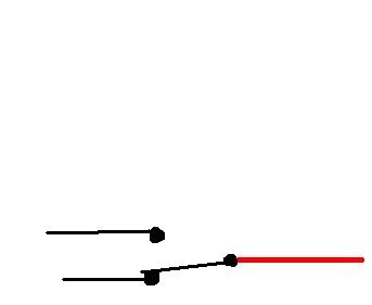

Postby Velvokay » 6 Aug 2010 17:20
Ok, so if your switch-lock has 3 terminals, one is a common, or negative terminal depending on the circuit. One metal terminal on the bottom(red in my diagram) is always connected So in any of the 2 positions, one terminal is off the other is on. It takes no power. here is a simpler drawing position1 - /- position 2 think of the slash as the common terminal,in one position current can flow through the right side only and in the other position current will only flow through through the left. the common terminal is never interrupted. say you have a battery and 2 light bulbs. you hook up the positive side to the common. and the positive terminal of a light to one of the other terminals , and you do the sam with the other. In one position one light will go on, and in the other position the other light will be on. So one of the two lights will always be on.

Postby Dak » 6 Aug 2010 22:54
Wow. Thank you very much. I understand now. It just switches current from one circuit to the other hence "switch" lock. Thats a very understandable explanation thanks. I might actually use these locks for something other then picking now. :D
