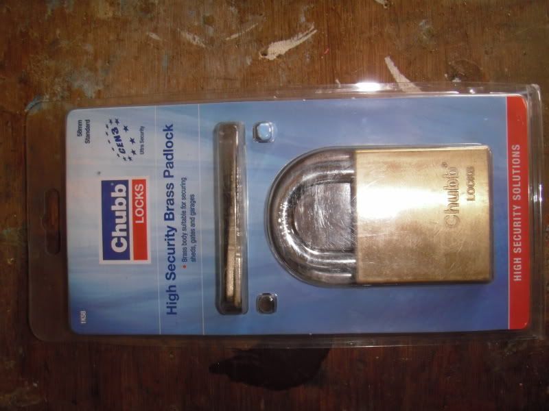

Postby Rickthepick » 6 Sep 2010 4:52
Il sell you one im in uk and will post for free.
NO crook will pick either of these. Id recommend the first as the shackle is restriced.
