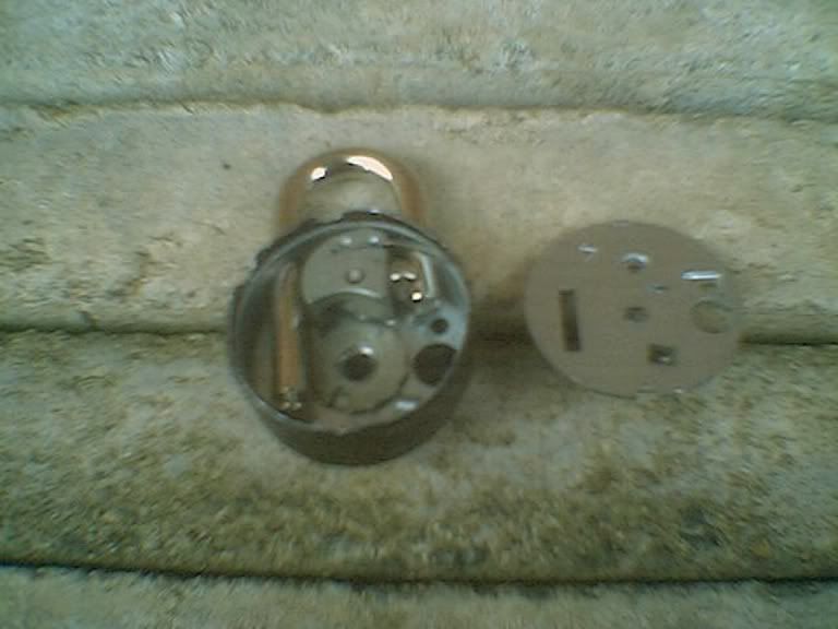

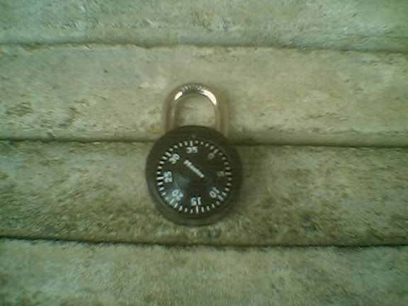

I brought a master combination lock for about £5.00, and eventually (i knew the time would come) i had to take it apart, but from the pics below, or ask me for more if you wish, could you tell me how to figure out the combination, preferably without causing to much damage to the lock:
i just up-loaded some pics so it would make it easier for you to explain???, i brought a master combo, but i want to know HOW to find out the combo, as i allready know what it is,but for others that i dont know, these are the pics: the one pic shows that the back plate is upside down, so the 2 other discs are not shown, but the first one is:
This is the lock in question
Internals and backplate
Pictures a re a bit blurred, so i will apoligise for that, sorry folks

Line up the spaces or gates in the wheels/disks there then fence will drop (the bar that drops into the gates) and the lock will open.

Once you have the lock open you can read the wheel pack by looking down the hasp hole in good lighting. If you don't have it open and can't shim it you can either try one of the manipulation techniques, or punch a hole in the back plate where the key bypass would normally be installed and read the wheelpack through the small hole. If you have the backplate removed you should see a hole in the thick steel back on the right sides middle. In that spot the only thing you have to punch through is the thin backing that the serial number should be printed on. If you still can't figure out where to punch, let me know and I'll post a picture.

Postby Ultimatederrenfan » 25 Oct 2004 4:44
Hey towch,
If you could post a picture, that would help, i have noticed the backplate but to clear things up for me, and help others, could you post it,
thanks in advance
