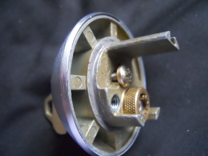

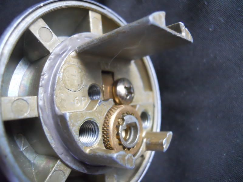

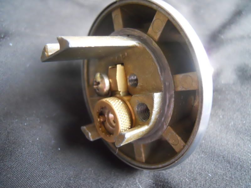

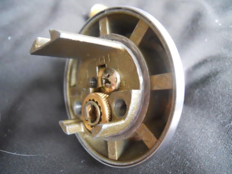

Guys I have a question. Can most of the Schlage deadbolt hardware they sell at Home Depot accept both the 5-pin and a 6-pin cylinder like in the pictures below?
6-pin cylinder:
http://i64.photobucket.com/albums/h182/ ... ure021.jpg
http://i64.photobucket.com/albums/h182/ ... ure019.jpg
5-pin cylinder:
http://i64.photobucket.com/albums/h182/ ... ure022.jpg
http://i64.photobucket.com/albums/h182/ ... ure020.jpg
And which knob set can you use a Schlage Everest cylinder with? I'm pretty sure the F-Series is probably out of the question though right?

yes as long as you change the retaining screw to the " other position"
Sorry I don't know about the "F" locks ,but "A", and "D" locks can as long as you have the correct tail piece

I had an F51 the other day that was able to be replaced with 6pin standard. Mind you I had to file about 1/16" off the top of the bible.
