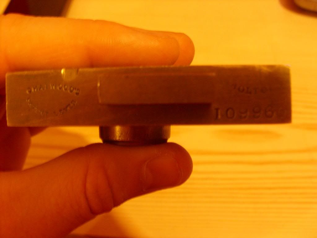

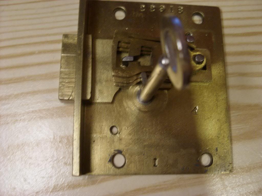

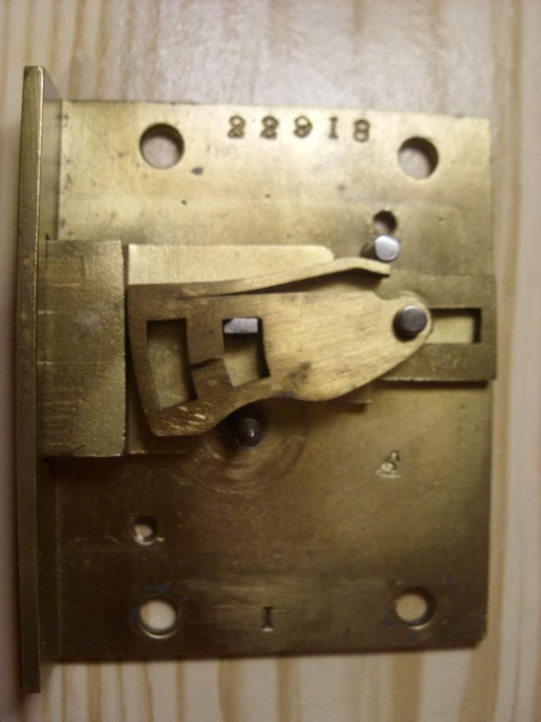

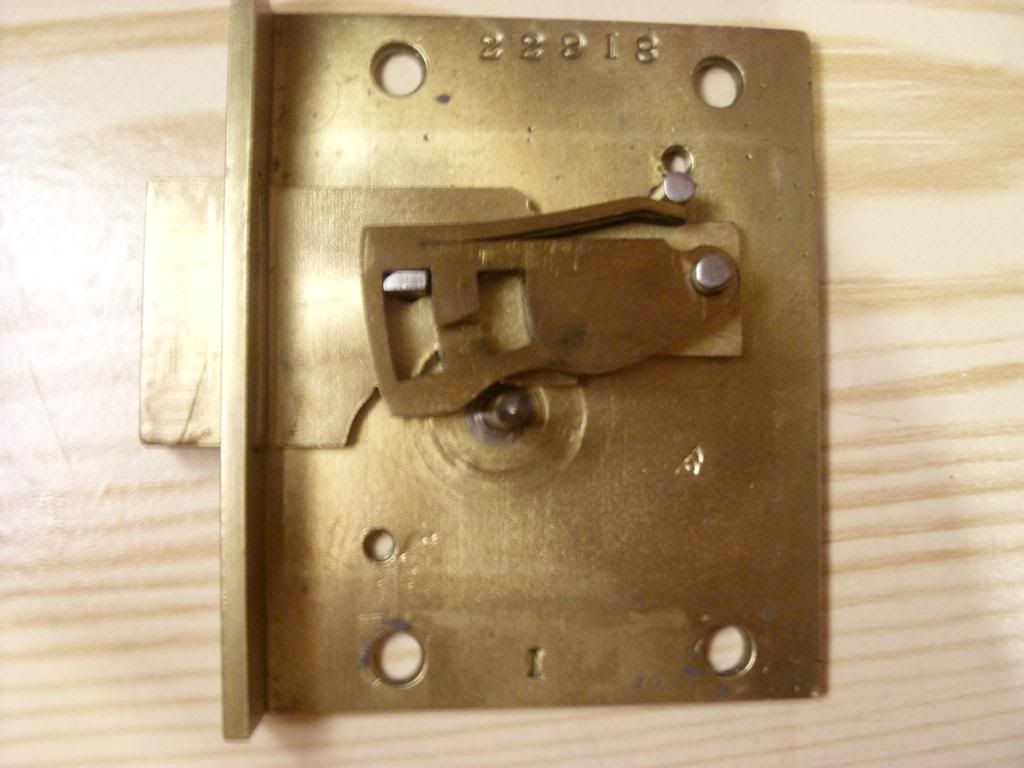

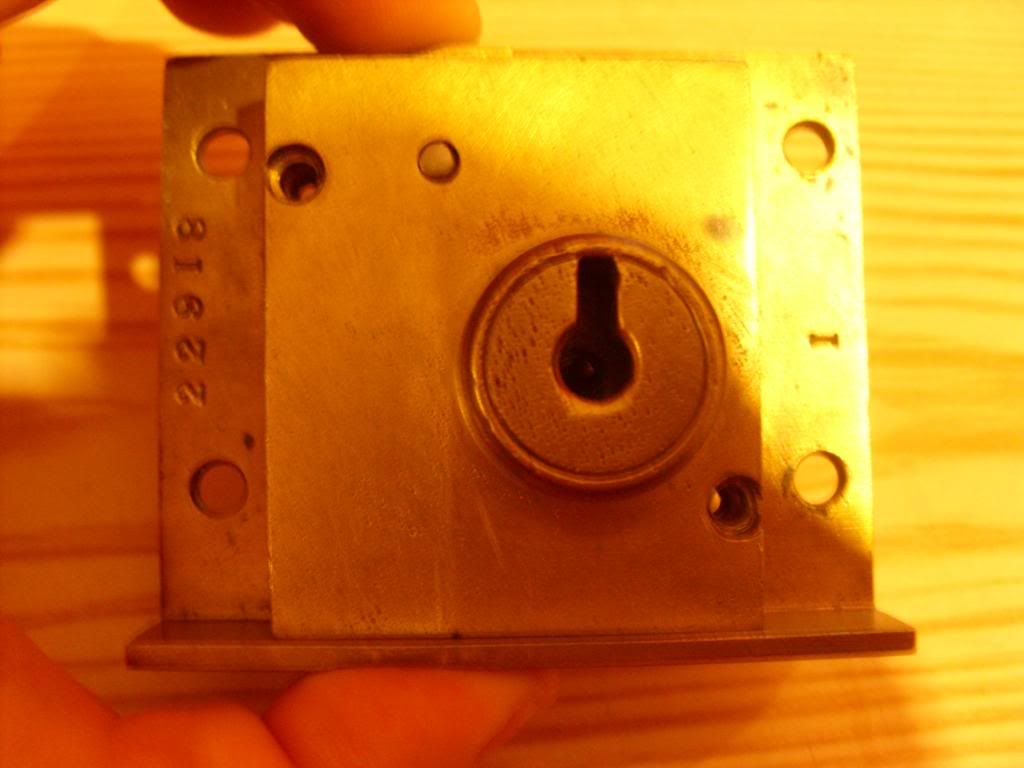

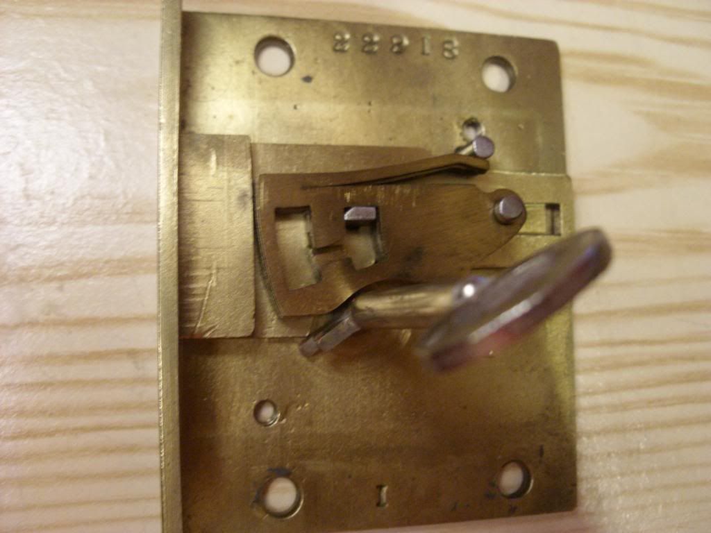

Ok, this isn't exactly a hard lock to take apart but I thought I'd post something that hopefully people find interesting ( For once! :P )
Ok well it's a lever lock that uses a barrel key and was made by an English company named Chatwood & Milner. The lock uses 4 levers and doesn't have much mech wise different to any other lever lock, except for the way the lever springs are integral to the levers, makes it fun to pick although it doesn't have any anti-pick notches.

Levers out:
Locked:
Being unlocked:
Unlocked:
