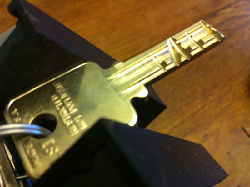

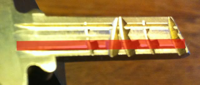

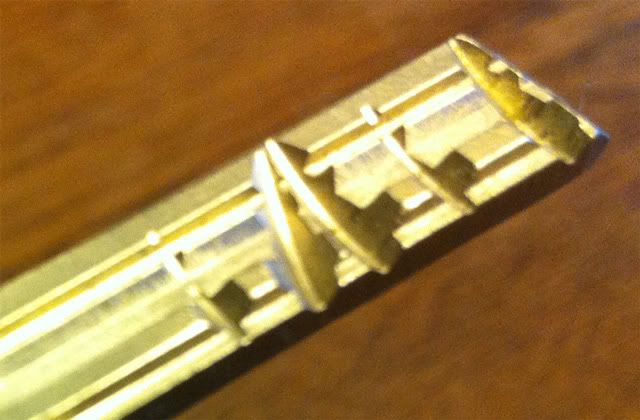

Postby MacGyver101 » 16 Apr 2011 7:21
Evan wrote:The width of the side of the key is MUCH wider an area to machine than what normal key machines are designed to cut...
Ah, true. What's not immediately obvious from photos, though, is that the cuts on the key aren't the same depth all the way across:
Something like your sliding mitre saw idea would be required, if the cuts had to be an even depth all the way across. What I'd tried to explain earlier (and likely not as clearly as I'd hoped) is that the cuts appear to just be made with a single press against a circular cutting wheel -- as the depth is considerably less on the left-hand side of the cut:
The reason for this, of course, is that only a small portion of the width of the cut is actually used; even though the key is far wider than normal, the pins are still a standard width. They only intersect the key along a narrow strip (which I've coloured in red):
...and, as a result, the depth of the cut doesn't matter to the left of where the pins contact the key. (Again, this is hard to see from most photos: it's much easier when you're holding the key and able to stare into the lock at the same time.)
