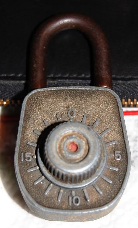

Postby wolf_from_wv » 7 Dec 2011 1:36
Any ideas for finding key blanks or combination codes?

Postby keysman » 7 Dec 2011 2:49
There is a lot of info available with a web search;
I found this U-tube on how to dial. The author indicated he may have a method to determine the combo.
http://www.youtube.com/watch?v=FjercE09kNs
There is also some pictures of the control key and some advertising material here:
http://vintagecombinationlocks.com/
Good luck let us know what you find out.

Postby Wizer » 7 Dec 2011 10:35
The keyblank looks much like JMA´s YA-27D,
http://www.sks.co.uk/products/standard/ ... key-blank/
Alltho I don´t know if they will ship to WV. Is that like Wolks Vagen?? :lol:

Postby Maintainer56 » 8 Apr 2015 16:33
I'm fascinated by Gougler locks. I purchased a batch of 13 from Ebay along with one of the flat master keys which was stamped "20". I took the code numbers which were stamped on the shackles to the Indy lock show last year and found an exhibitor there who gave me all 13 combinations from those codes. One of the Gougler models had a wafer tumbler cylinder on the opposite side of the dial. I've had good luck picking the cylinder and site reading the tumblers to make a key. I'd like to find more of the flat masters. There are supposedly 8 of them stamped 10 through 80.
