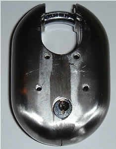

I believe that looking inside locks to see how they work is essential to learning the art of lock picking, so I've been opening some of my practice locks recently to get an understanding of what's going on behind the scenes.
This week I've opened a Master Lock 'Titanium' range padlock. It's a 'mid-range' lock and costs about £15. It comes with a thick black plastic outer case, covering a titanium shell. The shackle is hardened steel as usual.
First I levered off the outer plastic casing with an old screwdriver, then, with the lock in a vice, ground down the four rivets on the back of the titanium shell with my Dremel tool. Once the rivets were flush with the shell it was just a case using a nail punch, then a steel rod to push the rivets all the way out. There was also a small weld, joining the two halves of the shell together, just under the keyway. I used the Dremel with a reinforced cutting blade to cut through the weld in about a minute. Not exactly 'non-destructive' lock opening, but very effective :-) .
Here's the lock with the plastic casing and rivets removed:
http://img.photobucket.com/albums/v609/gsmyth/002.jpg
The shackle does not 'pop' open on this model, it works on a geared mechanism. When the key is inserted and the plug is turned it engages a toothed gear wheel to move the shackle clear of the casing. Here's the lock with the titanium shell and inner backplate removed (viewed from the rear).
http://img.photobucket.com/albums/v609/gsmyth/003.jpg
You can see the gear teeth that turn engage and rotate the shackle clear of the casing. The lock itself is just a standard four pin tumbler:
As I said, this is one of my pratice locks and I've been having major difficulty picking it open. The problem I find is that the keyway is very small and once the tension wrench is inserted there's very little room left to manipulate the pick to raise the pins.

Welcome to the wonderful world of minature tools.
The best I can recomend off the shelf are the HPC PIP-2000 series. Take your pick :lol: of sizes and handle styles. The 2000 series come in the rubber handled full sized royal set, the rubber handled short sized regal set, and regular PIP-2000 styles.
The Peterson "Just Picks" slender set, and the "slender gem" pick are also excellent choices for these types of locks.
One of the most overlooked parts is the tension wrench, as you have discovered.
While it does indeed fit, it isn't leaving you very much room. I recomend making custom minature tension tools that fit smaller sized keyways. These allow you a very good fit, and more room for your picks.

If the keyway is really that small, you could probably use a good hairpin for a tension wrench instead. I keep a pack in my room. :roll: They're pretty useful for smaller keyways.
