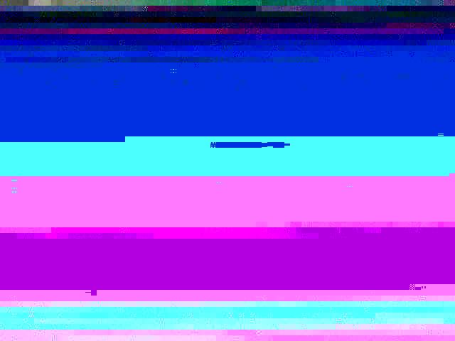

hello everyone .. this is my first post .. ive been lurking for a while and finally decided to join.. anyway i picked up a practice lock from a friend of mine not to long ago and this thing has been giving me a really hard time .. ive had it for about a month and ive only opened it 2 times .. (playing with it off and on) its a corbin lock and when you look into the keyway you can see what looks like round balls sitting on top of the pins (think ball bearings) im guessing this is some sort of security feature .. i also think it has spool/mushroom pins any tips on picking this beast?
i have a pic of it but i took it with my 2 year old camera phone so the quality is horrid

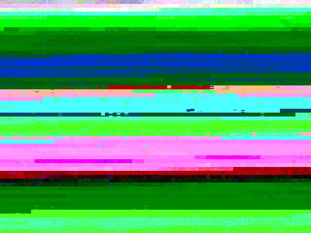

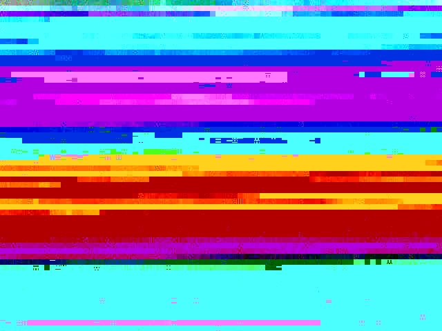

and while im at it here are some low quality shots of my homemade hacksaw blade pics
thanks to pyro for making the video that made those pics possible and thanks in advance for any replies[/img]

Thsi lock, you say has ball bearings above the pins... this came from a ball bearing master system which are commonly found in hotels.

The balls were origanly used to keep the pins from wearing too quick.
They are still available from Corbin. I still use them (from an old supply) because the locks I deal with see at least 500 openings a day. You can see the wear on a pin (usually the two front pins) on a cylinde that sees a lot of use. It is still easier to cut a key than to rekey a cylinder, especially a Corbin master ring.
