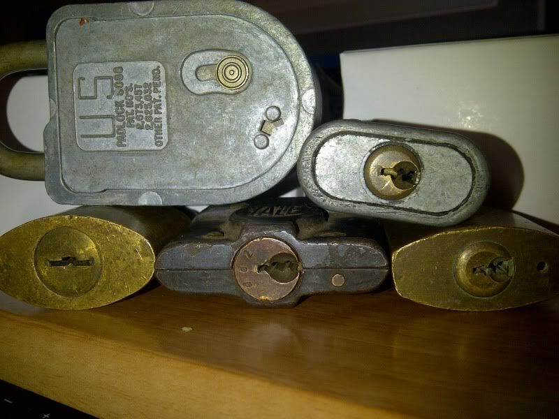

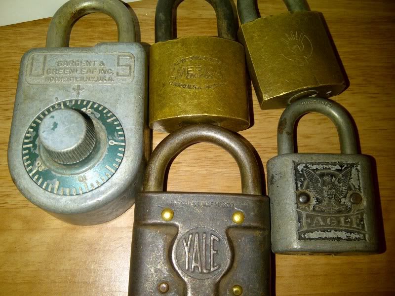

I was just at the Keady flea market in Ontario, and the God of locks must've been smiling down on me today as I found exactly what I dream of everytime I go to a flea market - a big box of locks.
Anyways, I was lacking cash after a few other purchases so I only managed to leave with 5 but I figured I'd share with the rest of the class.
The keyways are a little too tight for my Southord PXS-05 Picks so I haven't really taken a crack at em yet, but I'll get around to it tomorrow.
If anyone that views this has popped any of these badboys open before I'd appreciate a few tips - I don't really get a chance to play with old locks like this too often.
http://i14.photobucket.com/albums/a309/DarrenM/locks/Huron-Kinloss-20120529-00144.jpg
http://i14.photobucket.com/albums/a309/DarrenM/locks/Huron-Kinloss-20120529-00143.jpg

I was able to open up the American and underneath the shackle there was what I thought was some sort of retaining screw I removed it and it appears to have no function.. Am I wrong? If so - please correct me.

great haul! for that really restrictive keyway on that yale padlock the rytan minis would be my choice, if you can't get a hold of those, the peterson slenders might work.

Regarding the American padlock: With the screw removed, a small pin is designed to move out into the screw hole. That frees the cylinder to come out. The trouble is that after a few years, the pin is no longer free to move. It will probably be stuck with dirt or corrosion. Try soaking in a penetrating solvent for a few days. Then strike the padlock down onto a piece of wood (dont want to dent the lock) and see if you can bounce the pin out into the screw hole. If everything like this fails, you can drill a 3/64 inch hole through the keyway at a very shallow angle onto the end of the pin. It can then be pushed out with a piece of spring wire.
These are actually pretty easy to pick but are great for weather resistant uses.
Are you interested in trading the Yale. I dont have one of those yet.

Raymond wrote:Regarding the American padlock: With the screw removed, a small pin is designed to move out into the screw hole. That frees the cylinder to come out. The trouble is that after a few years, the pin is no longer free to move. It will probably be stuck with dirt or corrosion. Try soaking in a penetrating solvent for a few days. Then strike the padlock down onto a piece of wood (dont want to dent the lock) and see if you can bounce the pin out into the screw hole. If everything like this fails, you can drill a 3/64 inch hole through the keyway at a very shallow angle onto the end of the pin. It can then be pushed out with a piece of spring wire.
Here's an old post with a factory service manual diagram and photos of what Raymond just described to you:
viewtopic.php?f=9&t=7435&start=15#p233577

Good catch! From what I have learned about the S&G 8088 combo lock you have there may be little hope since the change key hole is closed. Try the factory combo set, either 25-25-25-0 or 10-20-30-0, if those don't work you will have to do it the old fashioned way (by telepathy or something)
