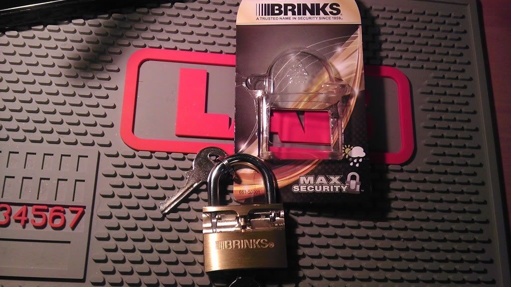

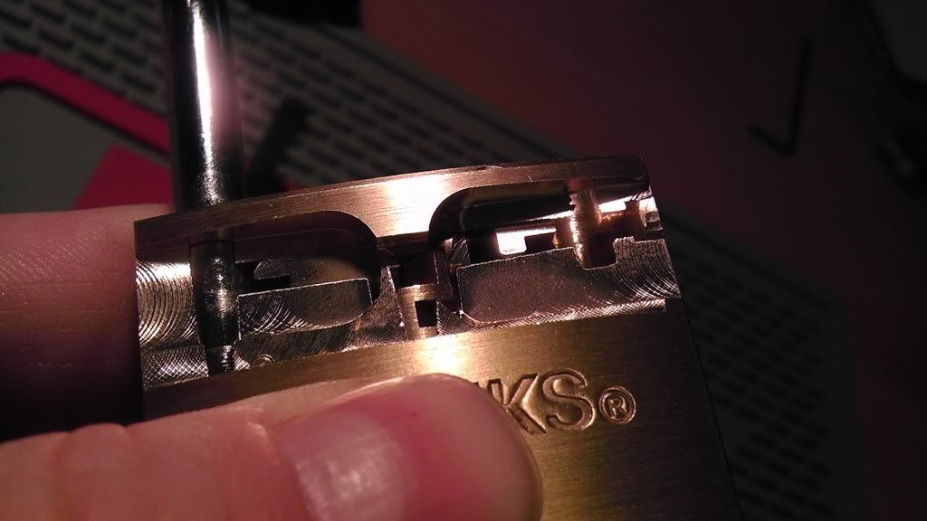

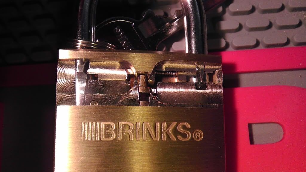

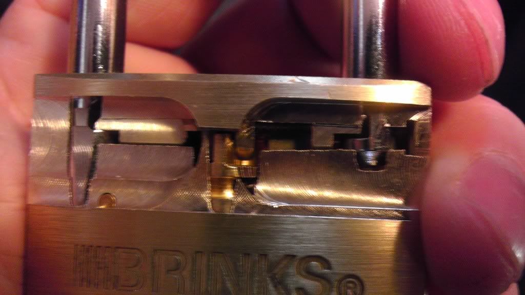

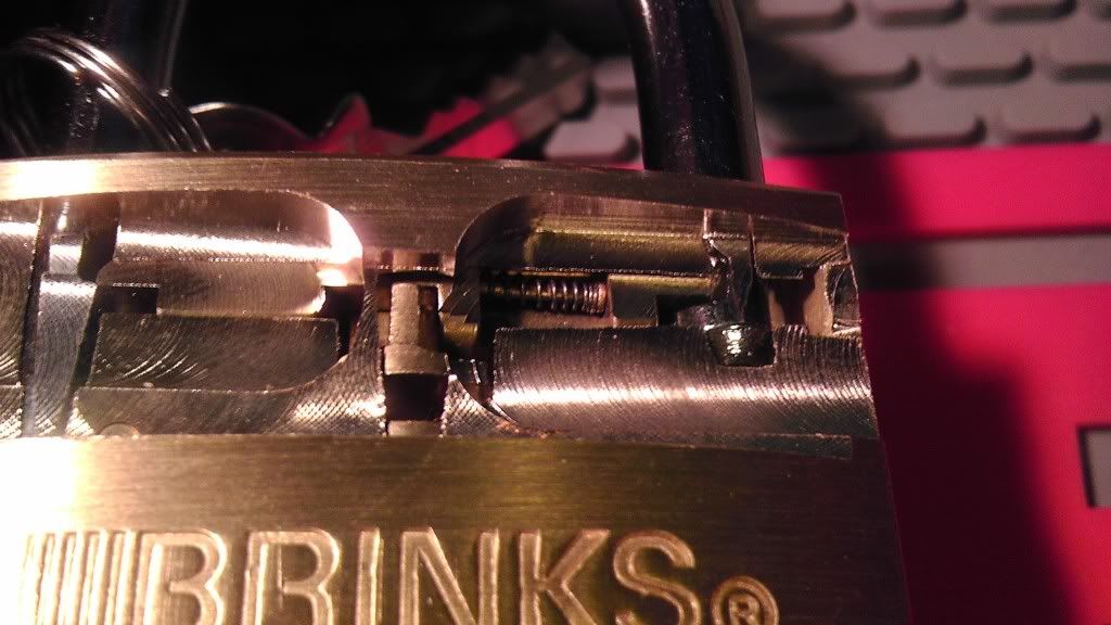

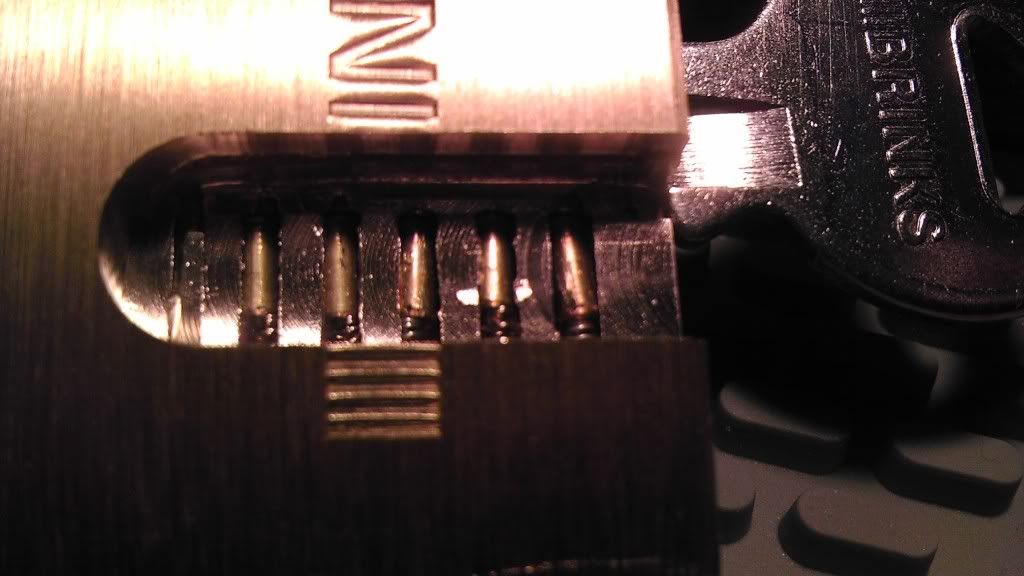

Postby Darkness1569 » 10 Jul 2012 9:45

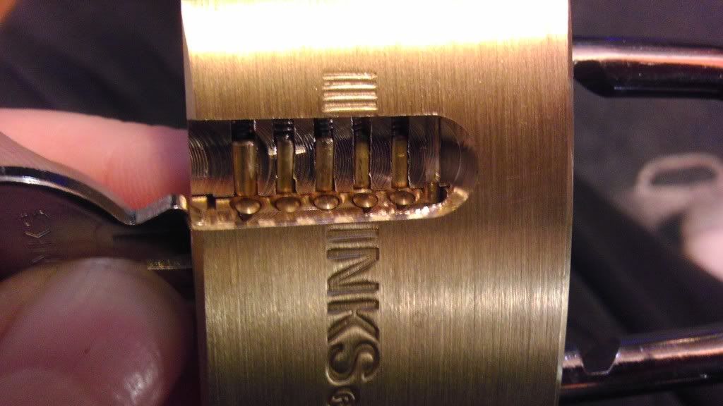

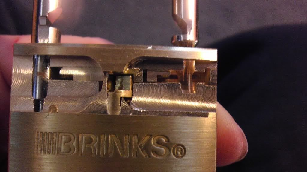

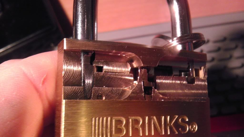

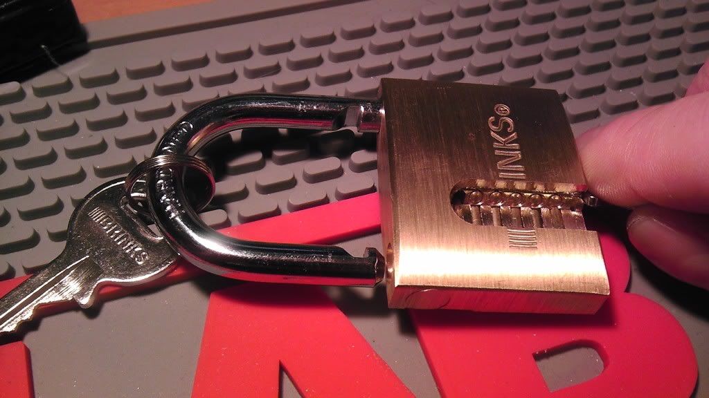

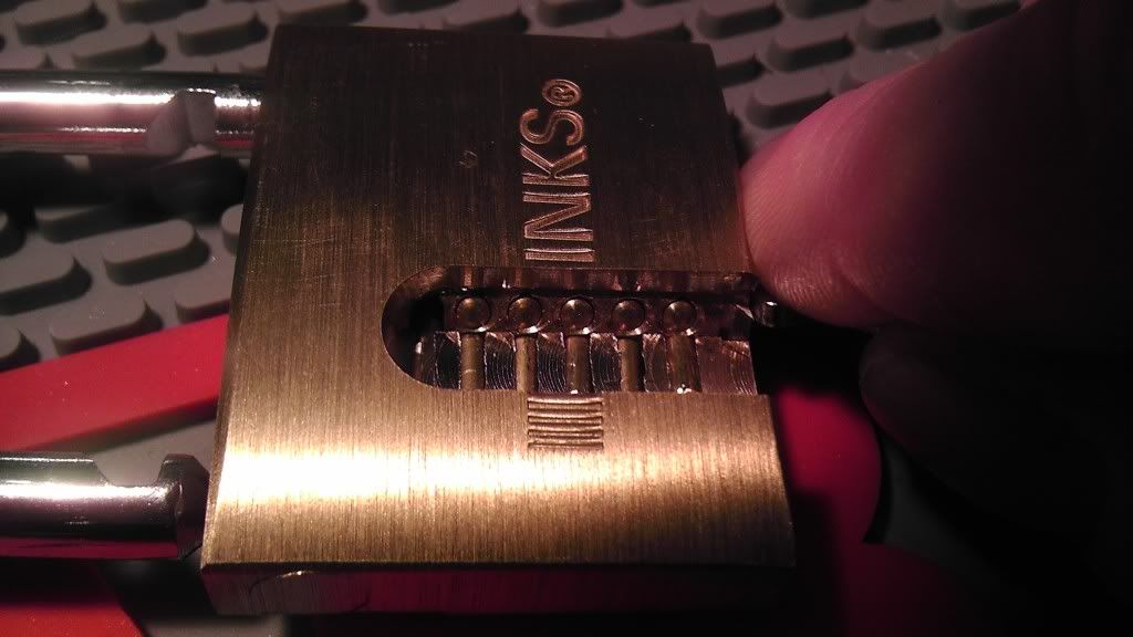

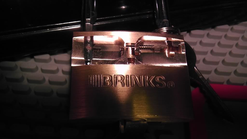

Here is a brinks brass max security lock cutaway. I tried to cut out the latches this time. Enjoy :D

Postby femurat » 10 Jul 2012 9:57
Great job, looks like you're not a newbie with the milling machine 8)

Postby MacGnG1 » 11 Jul 2012 18:45
lookin good! have you made cut aways on mortises before?

MacGnG1 wrote:lookin good! have you made cut aways on mortises before?
Thank you, No I haven't made one for a mortise, I don't have one. This is only my second one that I have done. I just wish locks were cheaper so I could get a huge range of differnt locks to cut open.

Postby atticRR » 12 Jul 2012 9:33
those locks look superb. Your first one was perfect as is this one, keep up the great work!

Postby SnowyBoy » 25 Jul 2012 7:40
Sorry to completely rain on your parade, but OH MY GOD! DID YOU CUT THAT WITH THE PARTS STILL IN THERE?!?!?!?!?!?!?!?!?!?!?!?!!
You are crazy. Making your cutters go through brass & hardened boron/steel at the same time is asking for trouble and possibly some missing eye balls. If your cutter caught one of those springs you would damage the cutter, the lock, and yourself.

Postby Darkness1569 » 25 Jul 2012 10:55
Thank you for your concern and the tutorials, you did a really nice job on your cutout.
It may not look it from the pictures but I did take some precautions while cutting it.
The CC bit I was using is for cutting stainless steel, I knew the shackle was going to be cut so that is why I went with a SS cutter, I was also careful and did all the cutting by hand and went very slow before I got to the shackles depth only taking .01" off a pass, and I was also wearing safety glasses.

Postby SnowyBoy » 25 Jul 2012 15:37
Darkness1569 wrote:Thank you for your concern and the tutorials, you did a really nice job on your cutout.
But the locking bars... they are loose in the tube as the cutter passes them. It will be decking the sharpness of your cutter instantly. The first rule of machining is to make sure all surfaces/parts are viced and blocked appropriately.
Please reconsider changing your practices about dismantling. If you need help getting a certain lock apart completely, PM me.
