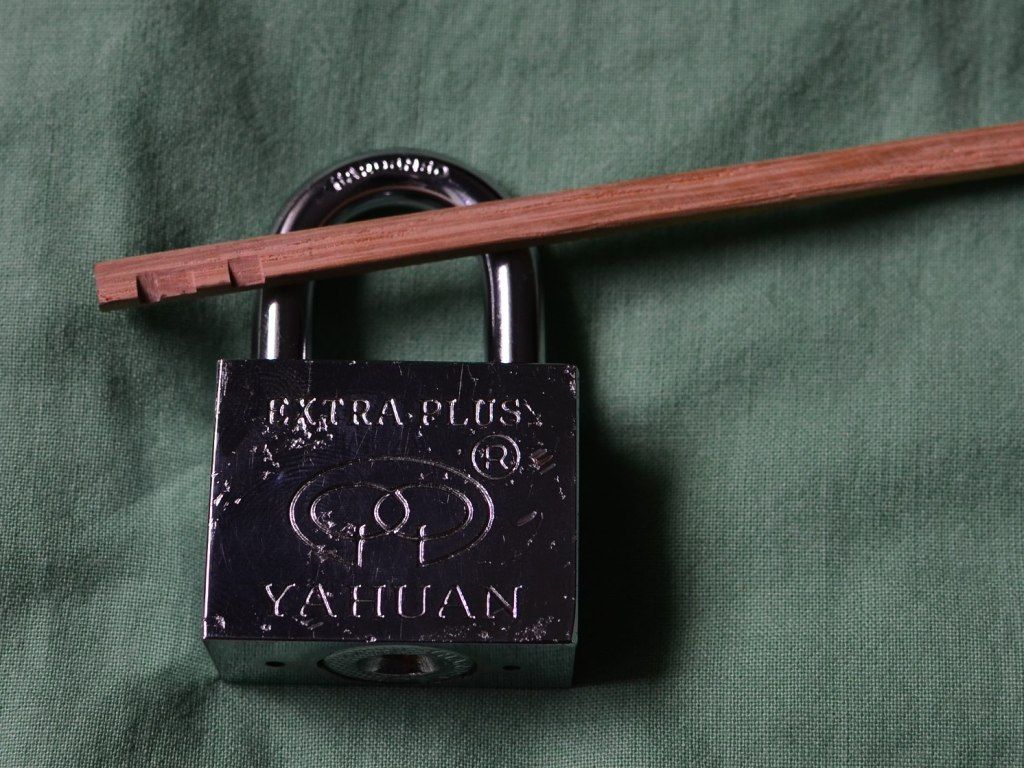

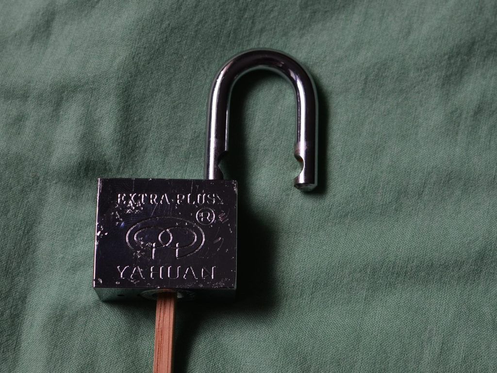

I was driving my car and saw this shiny padlock on the ground. Stopped and picked it up (easiest picking ever) and studied it - disc detainer lock, this is way too difficult - so I just didn´t even try to open. Until some evening when bored I picked it with doublesided pick and after 20 seconds it was open! I was a bit confused but anyway I got it open. Bonus is that when it was open I could decode disc postitions!
This chinese lock has 7 discs and cuts are made in 20 degree intervals. Each disc is 2mm thick. So I filed this key from oak, it doesn´t show well in the picture but there are 3 different cuts in this key. I will make a proper key from steel later. But no hurry as this wooden key works well. Well, I´m a carpenter 8)

Nice job on the key! There wouldn't be much point in making one out of steel, these things turn with no resistance whatsoever so I can't really see the wooden key wearing down. I'd imagine that's a nice quality hard wood you used, so carpent yourself a cool handle for it and use that. Seriously, that'd be cool as hell :D
As for picking, I've seen these jiggled open the way you did it before but it's not exactly the most reliable (or repeatable) method around. Very few of them will actually open like that so you either got lucky or have some kind of magic touch. Either way, congrats :mrgreen:

I guess I got lucky with that opening. And being also helped with easy bitting of the key.
It would be nice to use this lock some place and in front of a group of people say - "No, I don´t have a key but I just carve one from some wooden stick..."
