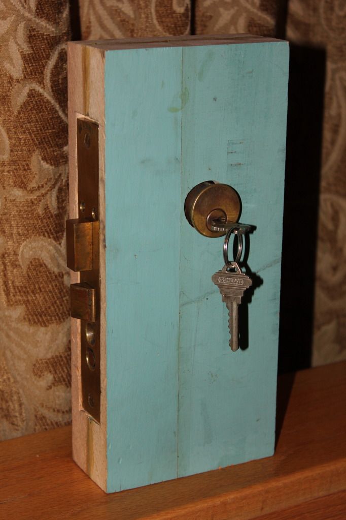

Postby Scajaquada87 » 2 Oct 2012 0:22
Update!
Well, I finally hollowed out the inside of a wooden block...took me awhile between drilling and chiseling, but the Corbin is now installed in something! Pictured is a no-name 7-pin cylinder (currently pinned 6 chambers) with a Schlage "C" keyway. I recently gave it a go with my 6-pin Best with an "E" keyway and it was quite a bit more challenging and a much better simulation for real-world conditions compared to having the lock mounted snugly in my vice. Granted, I still didn't have to account for a door frame or doorjamb, but it's still a step up.

Postby Altashot » 2 Oct 2012 23:35
Cool! :D
I have installed a few with the old spade bit and chisel too...
I know mounting one of those in a wood door is quite a bit of work
and time consuming. Try in a 1 3/8" door... :D
Good job! Nice rig! :D

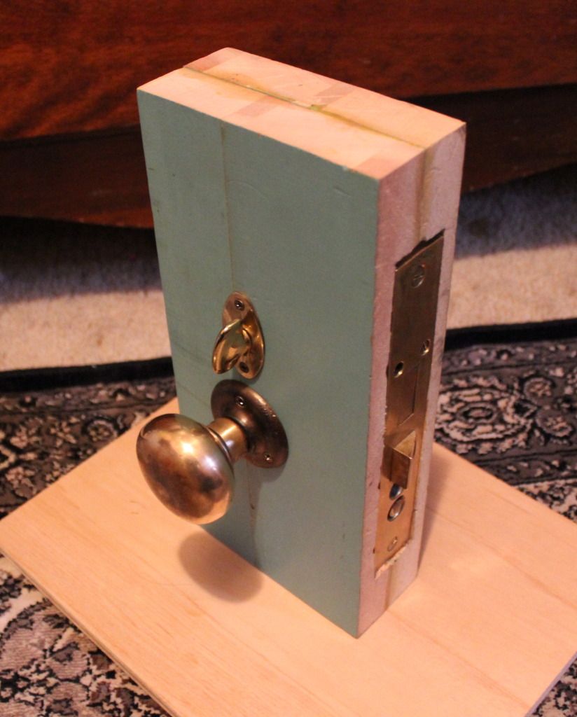

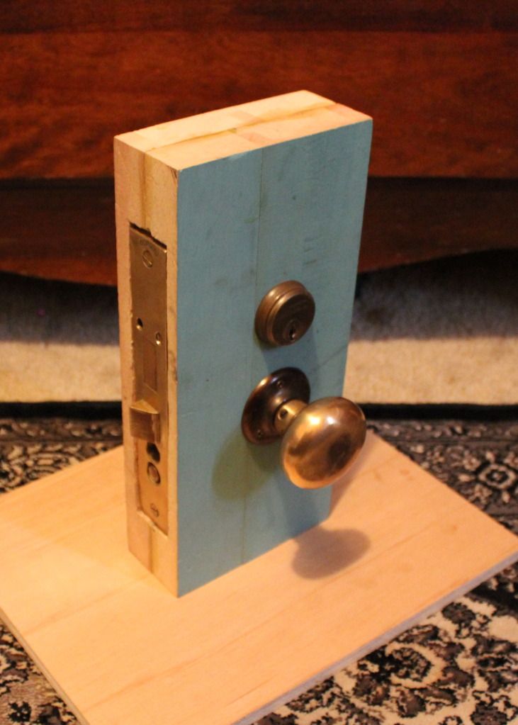

Postby Scajaquada87 » 5 Oct 2012 16:56
cledry wrote:When you say faceplate are you referring to the armor front? If so this lock doesn't use one.
Thanks for letting me know. This explains why I couldn't find a front plate that was 2.5 inches between the cylinder and the spindle (the best I could do was 3"). I realize that normally this lockset would utilize a door pull with a thumblatch on the outside, but I was thinking that maybe I could track down a used part from some other lockset.
Anyway, I ended up stopping by Historic House Parts, where I picked up a pair of brass doorknobs with a solid spindle and escutcheons. I was able to track down a cylinder collar and thumbturn in my basement amongst all the lock parts I inherited from my grandpa. Today I took apart the entire lockset, cleaned off the WD-40 (fixing my old mistake) and applied lithium grease to the parts. I then reassembled the lockset, placed it back in the mortise and bolted everything into place!
I decided to go with my Sargent cylinder, as the cam on it seems to throw the bolt nicely without getting in the way of things. Also, I mounted it on a stand so now I can practice picking it without having to hold the block. Picking cylinders in this thing is much more difficult due to the angle and the doorknob. However, I find that it creates more of a "real-world" experience and I feel that at this phase of my training that something like this wouldn't be as frustrating as it might have been a few months ago.

Postby cledry » 5 Oct 2012 20:15
The part you are calling the faceplate is actually called the escutcheon. The armor front faceplate fits on the edge of the lock where the bolt and latch comes out. Modern mortise locks use this piece but older ones didn't. Your lock may have had an escutcheon or not.
The old Sargent cam was similar to the old Corbin and modern Yale cam, so probably any of these would work in a lock of this vintage.
You have done a nice job with it.

Postby Altashot » 6 Oct 2012 0:46
Looks really good! :wink:
Good choice on knobs and cylinder too. I always liked to look of bronze finish. it develops a beautiful patina as it wears and polishes from use.
How does it feel with the lithium grease now? :D
