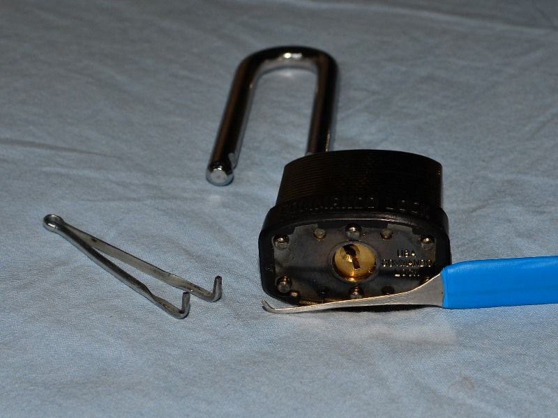

I was also fortunate enough to get a package from Commando lock company. President Patrick Smith was generous to send me two padlocks to testing, one military and one interchangeable shackle version.
Now I have spent a lot of time with them and found that they are pretty well protected against picking. 5 security pins with an odd feedback. Keyway isn´t that complicated so you can put your picks in it but it sure wasn´t easy. At least for me. This was probably my most awarding picking so far.
Tried raking it with every pick I have, changing tension and I only could get it to a false set.
Then changed to spp and after very many attempts could finally open it for the first time! After that close it and start again... second time it opened after 30 minutes. After ten years I maybe get it open in 2 minutes :roll:
At first I used normal tension, tried from up and bottom but finally moved to that double version, worked very well providing a good rotation to the plug. Thanks Josh66!
I also tried to pick it ccw but hadn´t success in it. The key turns that way when you change the shackle so you would think it´s doable.
As mentioned before, the shackle change is made very easy. The newest version has a machined groove to mark the location where the shackle attach, mine had a line made with a marker pen. Worked perfectly though.
Nice line of locks, thank you for the challenge!

Postby Josh66 » 9 Oct 2012 19:44
zeepia wrote:At first I used normal tension, tried from up and bottom but finally moved to that double version, worked very well providing a good rotation to the plug. Thanks Josh66!
I thought that looked familiar. :D
Glad it worked out for you!

Postby easy-e » 27 Dec 2012 14:08
Well it's been a slow week at work and I finally picked one of my Commando Locks. I've been practicing a lot and getting use to being able to actually feel the feedback from the lock. It took me about 40 seconds and opened first try. The 0.050" pry bar fits perfectly for top or bottom tension. Too bad the rest of my commando locks are at home.
easy-e
Posts: 117
Joined: 19 Dec 2012 15:13
Location: Seattle, WA
Re: Commando Locks a overview
Postby easy-e » 27 Dec 2012 14:44
Also managed to pick it in reverse to remove the shackle!!!
