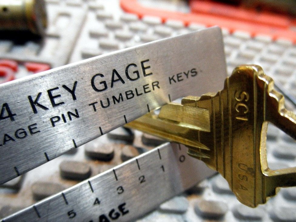

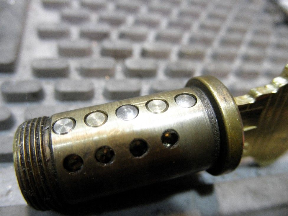

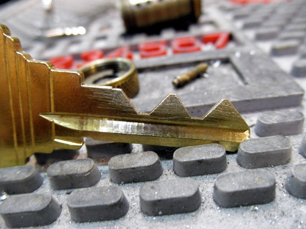

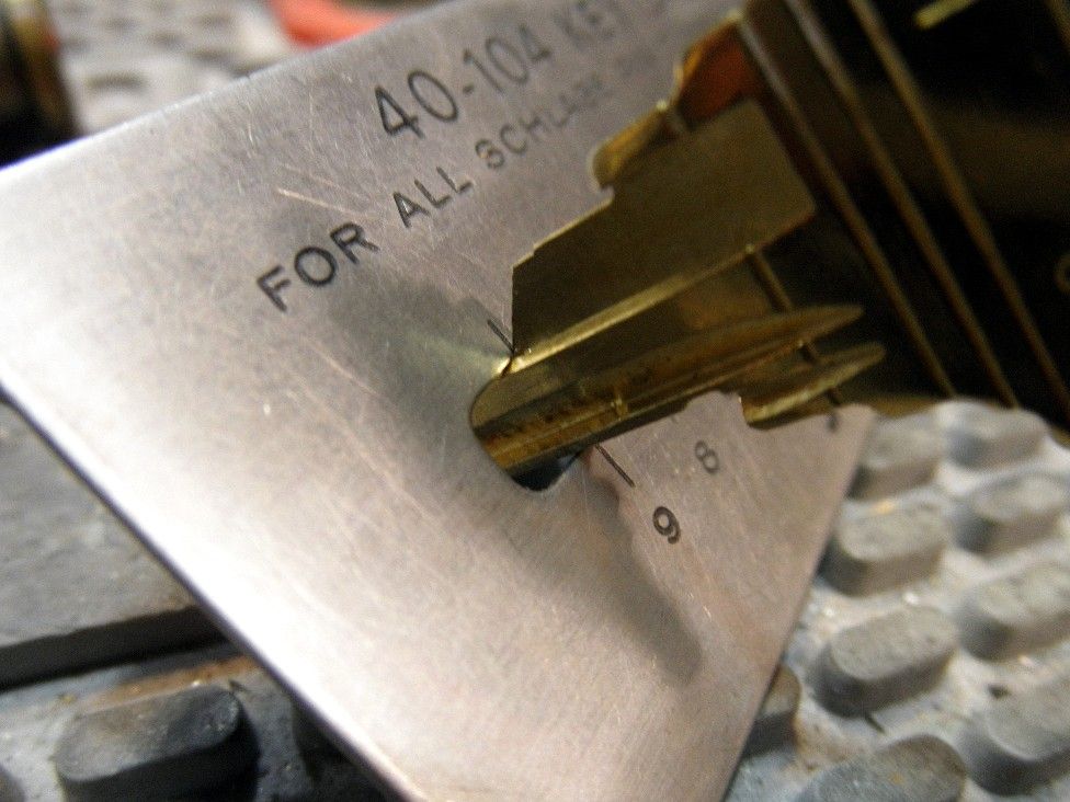

#1) I apologize if my arithmetic is lousy.
I was trying to say
10*10*10*10*10 = 100,000?
AND
10*10*10*10*10*10 = 1,000,000 ?
#2) Just because you shouldn't do it, doesn't mean you can't do it.
Here are a few photos of a Schlage key cut to 09090.
Using a Sargent cutter it can be accomplished, and the key works just fine.
Have I ever keyed a customers lock with a zero nine bitting?
No, but I know some other locksmiths that do it on a regular basis.
Anybody out there have an HPC1200 with this Sargent cutter that will back me up on this??

Postby Altashot » 6 Mar 2013 22:12
I concur.
It shouldn't be done but just for fun, it can be done.
I've even seen original Schlage keys that had 0 next to a 9. I change those for a better bitting but, they work fine.
LockDocWa clearly demonstrated with his HPC 1200 that even a severe bitting like 09090 can work and CAN be done. He also cleverly used the 47 cutter :wink: The recommended 1011 cutter would only leave the 0 to a sharp point but I tried and it still works, not well though. It's not to Schlage specs here, but it's OK to play with the 1200. I love that machine, The combinations of cutters and the ability to make your own cards and your own choices with the 2 cranks are endless...

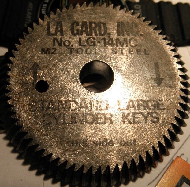

Altashot,
The standard cutter for Schlage is the 14MC.
The 1011 is for smaller locks, like wafer and master padlock.
Here is your Schlage cutter.

Postby Altashot » 7 Mar 2013 19:55
You are absolutely right LockDocWa, now that I can think clearly.
