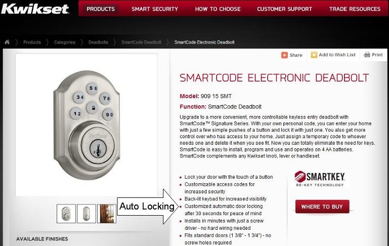

And if you don't want to look at the door to make sure it's locked:
We can discuss how much you love Kwikset in another post :) :P

ARF-GEF wrote:The kwickset looks nice, a pity that it"s kwickset.. :D Or aren't kwicksets very insecure? I don't know American made locks which are not high security well unfortunately.
If you notice that is a Kwikset Smartkey, wich is a pretty secure wafer with sidebar. Not top stuff. But pretty good. http://www.lockwiki.com/index.php/Smart_key

LockDocWa wrote:And if you don't want to look at the door to make sure it's locked:
I have this same lock on the door leading from the garage into my house. I'm out of town right now so I can't test it but I'm pretty sure that it has flashing indicator lights on the inside to indicate if it is locked or unlocked. I can't remember how it works but I've seen flashing green and red lights. You can set different codes and always open the lock with a key. I'll test it when I get home and see what the lights mean. Flashing red may be low battery but I frankly don't remember. I'll check it when I get home and post it here. It was an easy install and relatively cheap so it may be an option.

@ FGarci:Thanks for the info too (on Kwickset,) I know Kwickset Smartkey. I have currently an ASSA twin in my door and I don't want to let the standard sink. After all it's my hobby and it would be a shame to have a mediocre lock.
@Mikeh727: Is the core changeable? if yes to what kind of core? Also can it be programmed to require a codeand a key "simultaniously" too?

ARF-GEF wrote:@Mikeh727: Is the core changeable? if yes to what kind of core? Also can it be programmed to require a codeand a key "simultaniously" too?
I don't know if the core is able to be changed. But I do know that you CANNOT program the lock to require a code and a key simultaneously. It will open with a key OR the code, but you cannot tell the lock to require both. If I remember correctly, you can program it with an additional combination that allows a single access, such as allowing a service person to enter your home once. But it will only work once. The original combination persists.

Postby LockDocWa » 22 Mar 2013 1:10
That particular type of Kwikset does not lend itself easily
to having the cylinder changed out to a higher security
cyl. I guess with enough money and engineering anything is possible.
But, again, this is Kwikset were talking about here. Low Budget Hardware.
