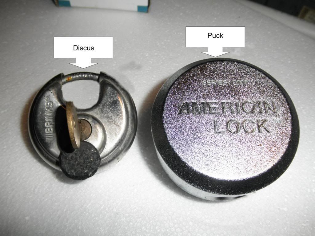

He is not referring to a discus lock, but a puck lock. I don't have a picture with me, but here are some Google pictures.
Posts: 7661

Postby LockDocWa » 23 Apr 2013 23:26
Just in case there are ANY questions about Discus vs Puck........
