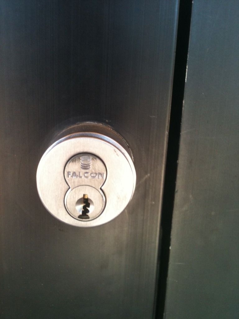

A Falcon Instakey is a neat lock that has glued-together pin stacks and precut keys in series. Using a special key, you can shear away one or more wafers in the stacks, which then makes the old key no longer work, and the next key in the series is used. Here is a PDF from their website on how it works.
Took this picture of one a while back while on a lock safari with my son. The picture at the top of the lock depicts the glued together pin stacks.

The falcon is fascinating too. But can't you just make(or emulate) a key which breaks away all the wafer either one by one or in bunches?

The instakey uses a special key with a slot in the bottom to make the change. They key has to turn to break off a section of pin, so not just any key will work. The slot in the bottom removes the master pin section. They often fail to work properly.
