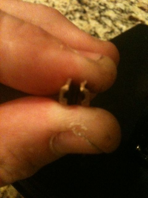

The main attraction that can be shown in the pictures is the new Y1 keyway! This is a huge change, and will keep many beginner pickers out due to the difference in how open the keyway is.

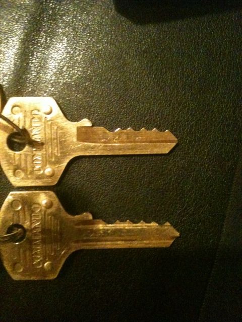

And the keys from the front:
The bitting is intentionally mild, and Patrick had a couple of other updates disabled on these so the lock cylinder can be isolated for testing. Note that both of the keys have exactly the same bitting. More on that soon.

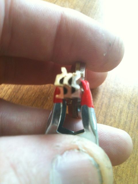

Here they are with the pick used to open them.
Inside where they are not as easily noticed, Patrick has included a few other treats. In addition to the normal spools they put into the locks, there are now serrated driver pins tossed into the mix. ***said in television spokesperson voice*** But wait! For Commando Lock Company, that's just not good enough! Now the prototypes are including not only spooled and serrated driver pins, but they are including serrated key pins!!! Not one or two or three, but five of them at no additional cost!!! WE'RE not done! as a special bonus Commando Lock Company's Prestigeous President has put in ... wait for it... wait for it... not just a bump pin. After all, numerous companies give bump pins. Commando had added even more innovation by including a serrated bump pin!
What is the matter with this guy? Doesn't he want anybody with a pick to be able to open the lock? In a personal interview ficticiously conducted last night, when asked that exact question, he answered "No! If they want to pick my locks, they are going to have to earn that ability. No stinking pick guns and bump keys are going to open my locks!

The spool pins are what we have come to love about Commando Locks. But the serrated add a bit of difficulty. By feel, the serrations are more clearly defined than you find on American (brand) padlocks. It is not as easy with Patrick's serrated pins. It is not as easy as following clicks. These serrations are larger and deeper. (Filipe... mind your mannors!) :mrgreen: you can't just skip over them like with the American locks. They catch and feel like you really hit the shear line.

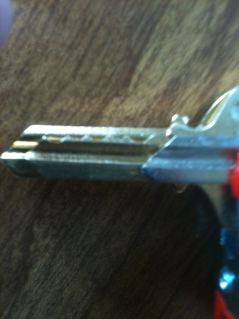

The bitting is very simple on these locks because Patrick was wanting the differences between the keyways able to be discerned. Identical easy bitting makes it clear that the biggest difference is access via the keyway. Yes, they will have issues with differences in binding order, etcetera. But the largest differences is navigating the keyway.

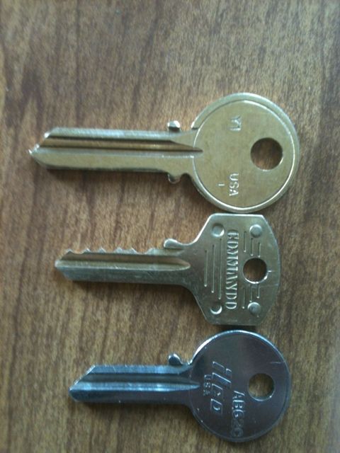

Postby GWiens2001 » 20 Jul 2013 10:03
dicey wrote:It is the Y1 keyway. The Y11 keyway is only possible with locks that have a larger diameter and therefore having 6 pins most of the time. A lot of people were suggesting the Y11 but the Y11 does actually not work with the small core or it would be more complicated to produce it. That is why he decided to use the Y1 keyway. Actually the name should be Y1+ if I am not wrong.
Top = Y1 blank. Middle = Commando Lock Company key. Bottom = ILCO AB62C (Y11 blank).

Postby Evan » 20 Jul 2013 11:02
Hey guys:
It is not Y1 (Ilco # 999) nor Y11 (Ilco # 01122)
Yale used to make brass solid body padlocks that used this same keyway...
It looks to my eye to be Y200 for 5-pin and would be 997B if it were 4-pin...
~~ Evan

Y1 Y1 Y1...You are all correct. Thank you Gordon and the gents at keypicking.com for the Yale keyway suggestion. At the time the suggestion was the Y11 which is the same keyway as the Y1. The difference, as Dicey pointed out to me in many of our offline conversations is the shoulder length of the key. I had that confirmed at the factory when they questioned whether I meant Y1 or Y11. Our cylinder diameter is too small to use the Y11 design that would hit on the last plate of the lock body preventing full entry of the key into the cylinder. 10 points for Dicey! I learned more from all of you about this keyway than I thought possible. As for the M1 vs M10, I believe there is a difference but that design was a gift as well and until recently I never questioned it. Is the M10 for a 6 pin maybe? but same keyway?
That said, Gordon, I'm thrilled you like the new design and want as much feedback as possible before we go into full production. Was the new M1 easier or tougher than the current M1? The current design has only 4 security pins and one standard bump pin as you pointed out. Our current pins are hybrid serrated spools. The new design has the deeper cuts and true variations of each type of pin in addition to the custom bump pin. Without adding a full set of serrated key pins, my hope is that the new M1 is more difficult to pick than the existing. Worst case is we add them.
As for the Y1, I'm thrilled with it and agree that with fun bitting this will be a significant improvement over our current cylinder. As you know, our goal is to match or exceed the old 5200 by American Lock and offer a value unmatched by our competitors. We'd like to be considered a great lock at a great price. The stainless springs are intended to add more pressure to a slimline pick. Squids don't fit as well and I'm not a big fan of cats.

One more detail regarding the Y11 vs Y1 keyway--even though we have a custom key, I had to clarify that we can have only one shoulder vs two. This was part of the available differences as well. With only one on the bitting side, the key fits.

The M1 blank is 4 pin, the M10 blank is 5 pin. The actual keyway name is something different than either number, but not being a locksmith, I am not sure what it is.

Postby Evan » 20 Jul 2013 15:12
GWiens2001 wrote:@Evan - Thank you for correcting my misunderstanding of the ILCO key number. :D I still have tons to learn. That is why my signature still has not changed. I appreciate all the knowledge that so many people here share with me.
It is cool man... It comes from years of making keys and having a key blank directory to refer to...
As far as master locks are concerned, M1 is called #1092 by ilco, K1 (blank) W1 (keyway) by Master... M10 is called #1092N by Ilco and K15 (blank) W15 (keyway) by Master...
