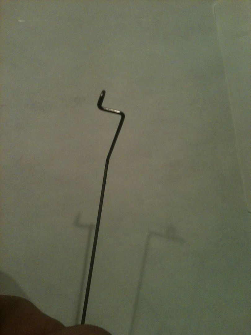

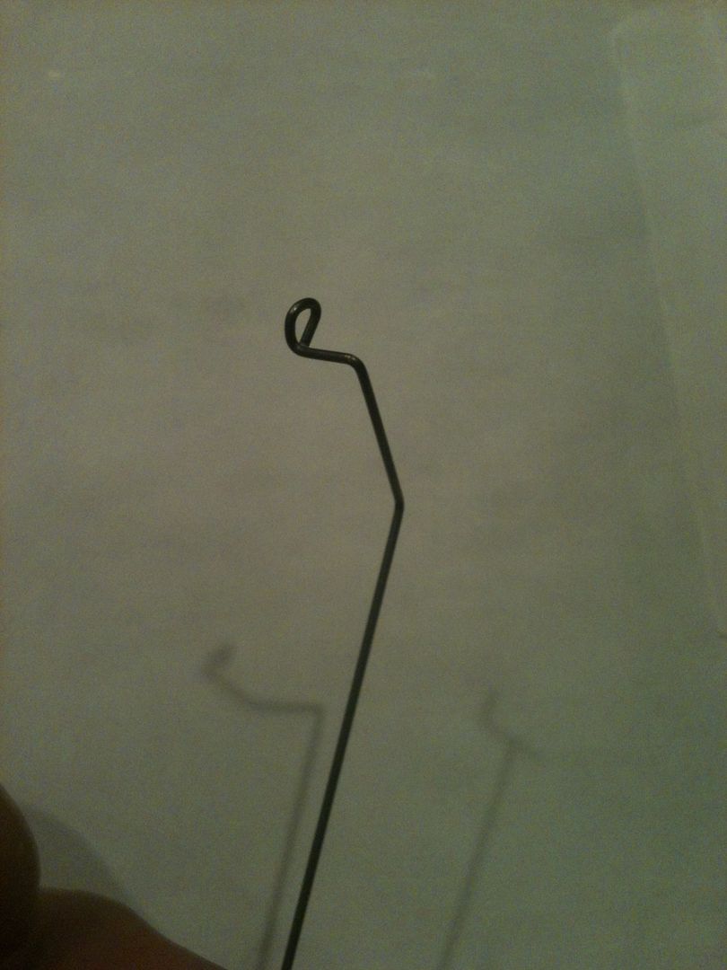

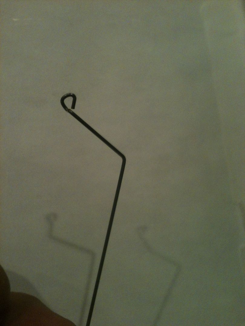

Postby GWiens2001 » 9 Dec 2013 21:21
MrA - like the collection!
How to tension the AXI. Use music wire to make one of these:
Then a standard hook or a reach tool will fit inside the center. Use the apex of the triangle opposite the row of pins for leverage.
You will be moving around from side to side a bit to find the binding pins. Also finally made a 'flat rake' out of a bobby pin, and that worked a bit better than a hook.
