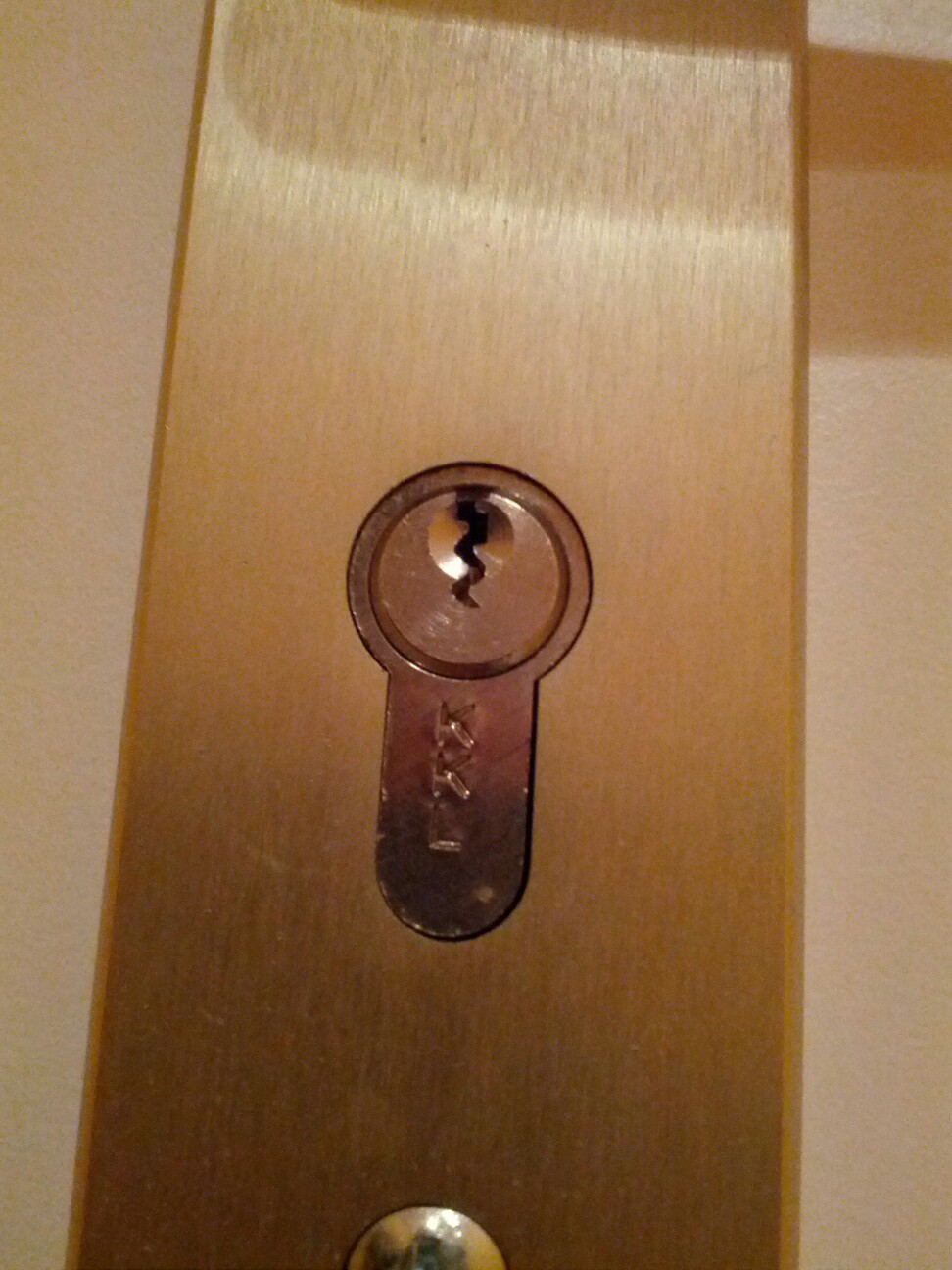

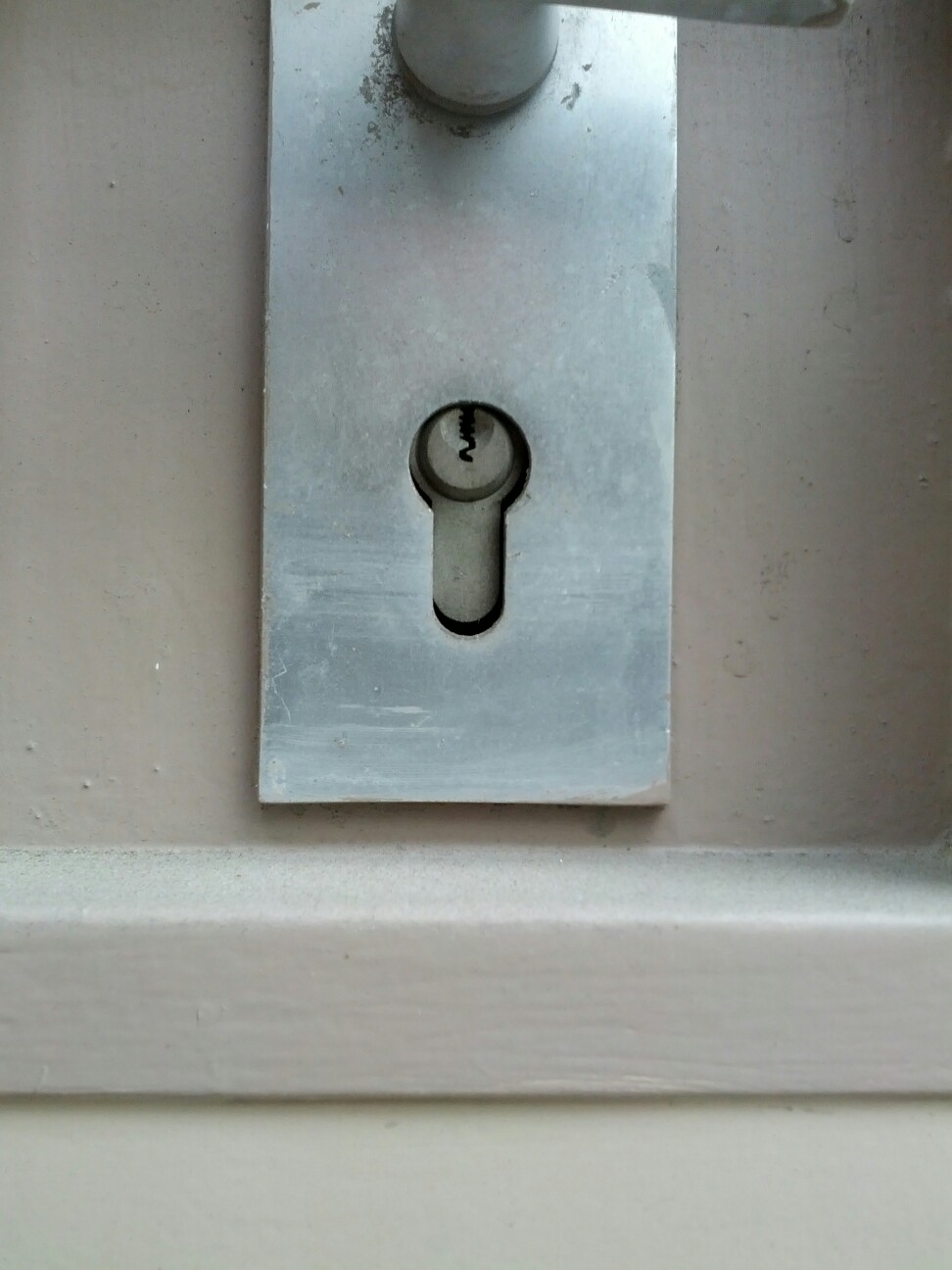

As I am somehow now much more aware of locks in everyday life, I too noticed some locks having very curved keyways. Would the following locks be pickable using standard slim line picks? If so, how? If not: What can be used on these locks?

Many of the euro profile locks have paracentric (twisty keyways that a straight line from top to bottom can not fit because of the warding of the keyway) keyways.
Seeing the KALE, guessing you are in Turkey, or somewhere near there. If you fill in your location information, people in your area can probably let you know where to find the kind of locks you are looking for.

I've never seen that lock or keyway, but pretty sure it's not a KALE, as the face reads 'KKL'. A quick google search didn't turn up anything about the lock. It doesn't look like a very well made lock, it has a snaky keyway though and may have spools.
The no-name cylinder has an even nastier keyway. I'd say if you are just starting out leave these kinds of locks alone for a while and try to find something without spools and a straighter keyway.

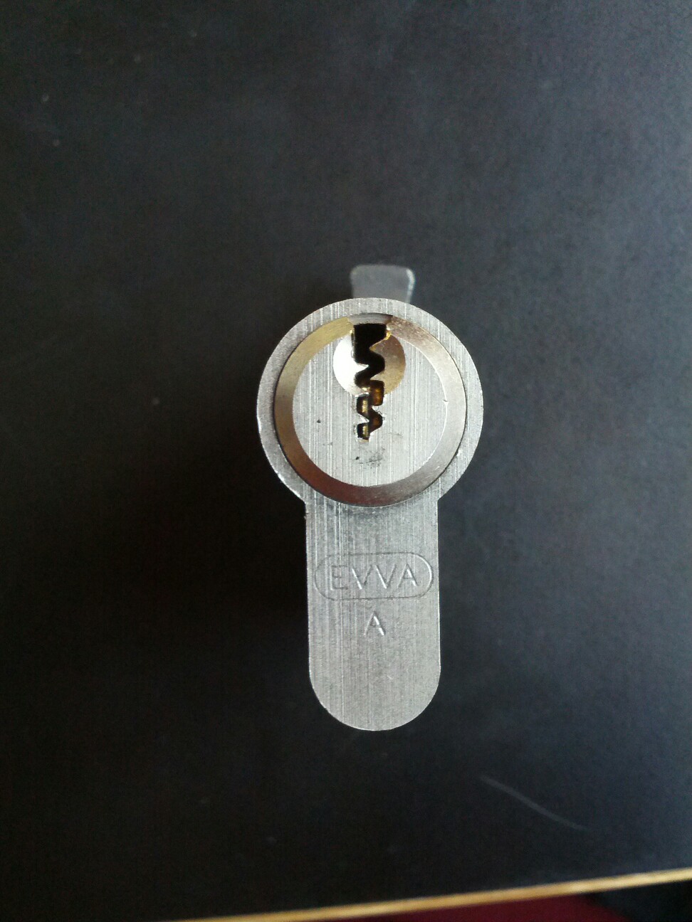

Yup, it does say KKL. I also assume that it's a cheap lock somebody just branded. But to make things more interesting: I was able to get a lock with an even nastier keyway which I can try to pick as I own it right now (unfortunately, the person I got it from can't find the key for it anymore, but as it's Evva, it probably has some decent bitting too):

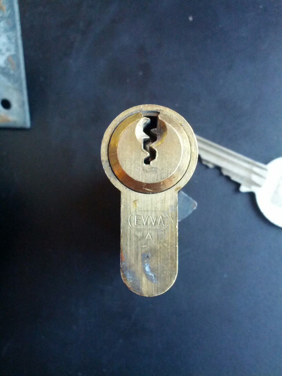

Got another, fairly old Evva (the key says, i's a GPI) from a flea market which also has a pretty decent keyway (but no way as nasty as the one above):
Any ideas of how to pick such a think? Especially the first one.. I'm not even able to fit one of my picks (Southord Slimline) in there. Not even the short hook. :roll: (the two topmost wardings have no pinholes drilled) And yes, I'm using much simpler training locks right now.. Asus 80Ti/45 atm. :)
Does anyone know, which Evva the first one is exactly? I've got about 5 or 6 different, old Evvas lying around, most of which have different keyways. Is there anywhere a source for the history of Evva locks (Which models did exist when and how to distinguish them)?

Geez, that first key way is insane! :shock: :shock: :shock:
